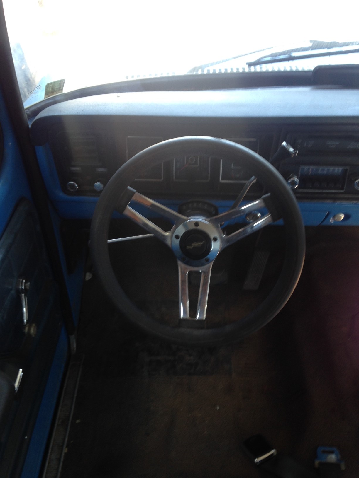

Ok , I think the worst item on the truck was the old weather-worn steering wheel. I had an old single cab that I picked up for free and it had a steering Column with a Grant steering wheel. So, no brainer out with the old and in with the sexier not as old. I think this maybe the first time I installed a wheel correctly with front tires, spokes on wheel and bolts, clocked right and everything headed straight down the road.

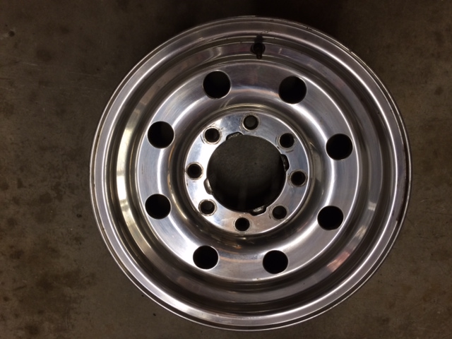

OK guys would his vintage of 8 lug ford wheel have a 8x6.5 lug pattern?
Re: Oldbaja. Chase
Those look like newer ('99-newer) SD wheels with the metric bolt pattern.
Re: Oldbaja. Chase
Yes Rob - you have 8x6.5, and Todd is most likely right. BUT...! The E series, 8 lug vans didn't go metric like the trucks did, & I'm pretty sure those wheels were offered on the vans, so there is a SLIM chance those could be 8x6.5.
These ARE 8x6.5 though & look dead sexy. Plus I know where to find a set or 6 if needed...

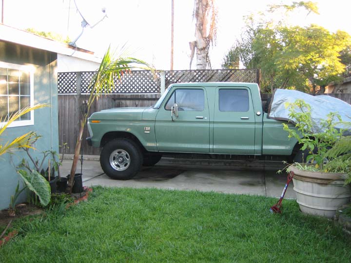

Maybe this will help you visualize...
Not the greatest pic by any means, but the only one I have while I had them on.

Steve......do you have those alloy 5 spokers in 8x6.5??
Re: Oldbaja. Chase
Nope. Sorry. That pic was taken in 2007. Those things were sold when I found my 1st set of the 8 hole ones I pictured above a long time ago. While the 5 spokes don't look bad to me in that pic now, I remember not liking the look at the time. Center/bolt pattern seemed so big that you really didn't get they were a 5 spoke IMO. It's like the regular Alcoa 5 spoke version. Loved them on my supercab but the 8 lug ones just looked "off".
These are a strong wheel though. They are made for Ford by Alcoa & are forged.
The ones above in my pic had been machined & sleeved so as to change the lug pattern since they were originally metric. A wheel shop up in Long Beach used to so this for $25 per wheel. It can still be done easily, just not sure of cost as it takes a mill to do it right & finding a tire/wheel shop that actually knows how to use one of those any more is a long shot. But if you know a good shop that can o it, it may be worth grabbing the wheels you pictured & having them converted.

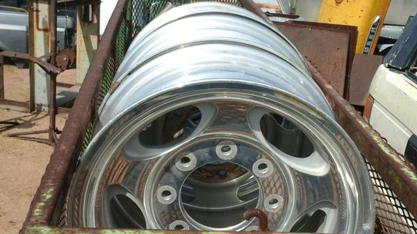

Here's a pic of the steel sleeves they insert in the wheels to convert the pattern. These are the 8 hole design alcoas off a 2001ish Super Dookie that a buddy now has on his 70's chevy.

If not, you can find the sleeves online (they are a steel sleeve with a knurl and have a built in tapered seat for the lug nut), and maybe a normal machine shop could do it.
The 8x6.5 wheel pattern is VERY close to 8x170mm as 6.5" = 165.1mm. So that's 5mm off center line on a 6.5" circle. I would THINK (haven't done this so don't know for sure this is how it's done) the machine shop would just set up the center of the hole for the 8x6.5" pattern & then drill out until it hit the outer limit of the stock, 8x170mm lug hole. This would make maybe a 11/16" to 3/4" hole I'm guessing - maybe smaller, and then the steel inserts press into that. Seems like they might spot face or counter bore the face of the wheel so the lip of the steel insert sits flush with the face of the wheel.
I would also think someone down there would have the capability to do this though. Maybe ask John or Darrin if they know someone off hand. A good, old school mom and pop wheel shop is who you'd be looking for.
