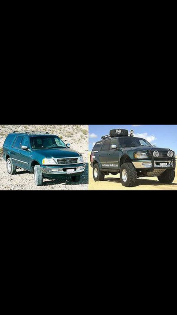

Tony - Throw an 01-03 bumper on that beast!
Re: 98 Forest Green Expedition
Madmaxwell87 wrote:I loved my expedition when I had it. The air suspension was converted to Coils and helper shocks. It was floaty but never had to deal with any issues from the crappy air ride system ford put on them. The plugs won't blow out if you torque them correctly, there's a tsb out there about the proper amount. They are basically F150's from the A pillar forward and the only real differences being the AWD t case( 97-98 had a 2wd option, not AWD and you can put a switch on the brown wire to have it be RWD instead of AWD) and coil sprung/air bad rear end. They are heavy tanks that get bad mpg, especially with the 5.4 and bigger tires. Mine was fairly optioned out. If I didn't move and get a new job I'd be driving it today.
Your rig helped me get to what I wanted....... hahaha. My air suspension is noisy, but rides great and so far doesnt leak so I am leaving it. Mine is a 98, so it has the 2wd option on the T-Case. Im digging it... first trip to Mexico coming shortly!
Travisfab wrote:Tony - Throw an 01-03 bumper on that beast!
Working on it... do you happen to have a lead on one by chance?
Agreed the '01-'03 bumper will step up the looks a bit. I'd leave the valance off too personally.
Forget all that, you know what needs to be done Tony. Go big. ;)
You'd have to swap the grill as well...99-02 grills dip down...97-98 are flat

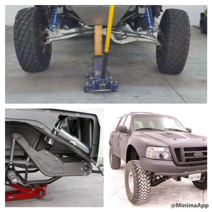

I already sent him this.
I think Fat City Erik and Ryan could help you out.... haha
TTB front with Mezzy rear setup. Glass all around and 37s........
Exactly.
8-)
By far the cheapest way to get legit travel, maintain rear seating and not break the bank as I said before.
Ok...that's sick...lightning motor swap...
Nope better yet edlebrock sells a 50 state legal super charger kit with a tuner preprogrammed with a carb approved setting list. I texted tony the other night telling him what I had planned if I were to ever build an expedition when I saw he bought one, and that collage of photos I made over a year ago. I did all the homework already for the most part and it's a very easy build. I told him just cause it's a family ride dosnt mean it has to ride like shit and it's a hell of a lot cooler than a skyjacker tortion bar lift kit.

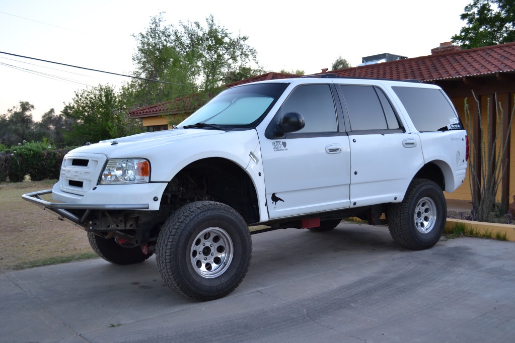

That body looks cool in white too:
