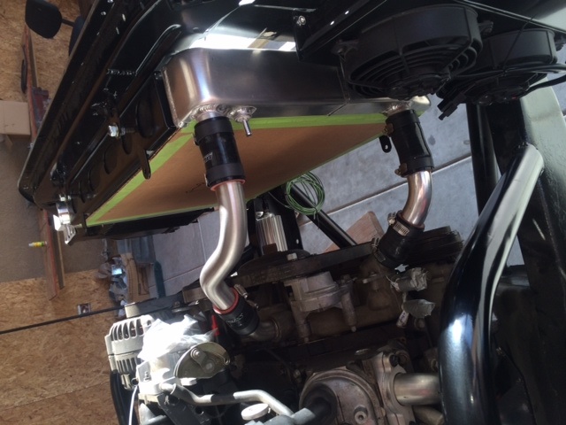

Got the radiator lines done on the truck tonight.
Gonna get the fan shroud drawn up tomorrow.
Hoping to mount it and the fenders by next week.

Made the fan shroud today. Need to fuse the corners, install the flaps and fans, and on it goes.
Should have photos tomorrow.

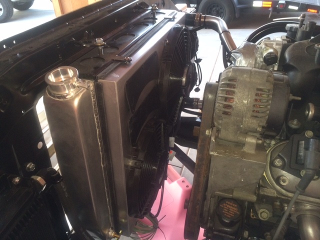

Got the shroud mostly together, so I propped it in to take a look.
Need more rivnuts to continue.
Next will be beefing up the fender supports this weekend, and maybe get the fenders installed..

Why the black covers on the fanshroud? Is the purpose the extra holes covered until highway speeds the wind pressure pushes em open? Looks really good btw, just a curiosity question.
Bootleg1
- Posts: 52
- Joined: Fri Aug 24, 2012 7:50 pm
- Bronco Info: No Bronco. Looking for one when I fell into a Blazer. Also have 68 F100 prerunner.
Re: The Vieja
During the time when the fans are not running, it will allow the air to pass through to minimize hot spots in the radiator. Once the fans kick on, they suck the rubber flaps shut to draw air from the entire shroud, rather than just pull from the fan area. Provided the fans have enough power.
I was only able to squeeze a 12" & 10" fan on there. If it doesn't pull enough air, I will switch to a single 17" fan with a larger motor that can overcome more static pressure.
