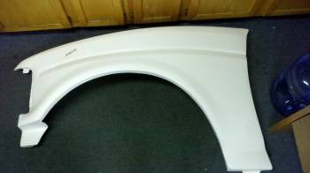

Fender fairy stopped by

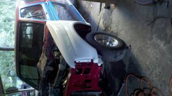

Core support is in and started the fender install
Re: 95 f150 4x4
6 inch flare?

Re: 95 f150 4x4
Post by steve-oh »
I believe 4.5

Post by steve-oh »
Did some more fender fitting got the liners trimmed and fitted in. Was hoping the 2wd front would be ok for the 35s and the new fenders but there going to rub a little so looks like ill have to put the the 4wd front in. Wanted to do all that when i did the c&ts and coilovers but this has to go to paint next week so i got my wheels back.

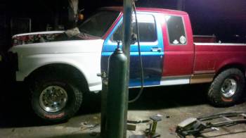

Post by steve-oh »
Going to pull the bed sides too, looks a litte funny with the rear so straight
Re: 95 f150 4x4
Looking good so far.
Re: 95 f150 4x4
I think the pulled bed sides will make a big difference. Looks good!
