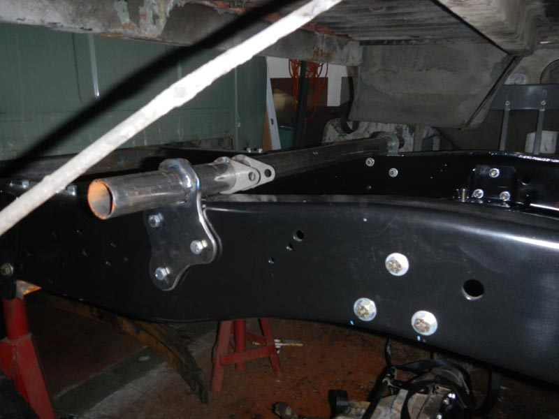

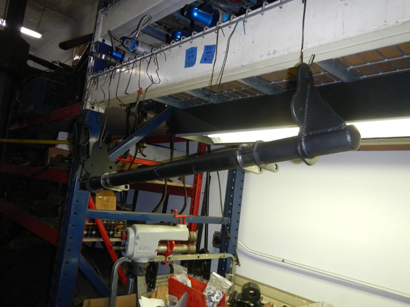

Yeah the F series have a much tighter space for the shock up there. Here is my solution.
I could only get an 8" shock to work without hanging the bottom shock mount way below the axle. This limited down travel a bit as I had to strap it before the shock would be the limiting factor.
If you're OK with running the shocks 4 or so inches below the axle a 10" stroke shock can fit. Watch it at bump though as the longer body of the 10" shock will get close to bottoming.

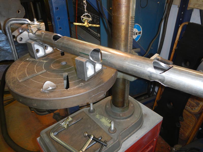

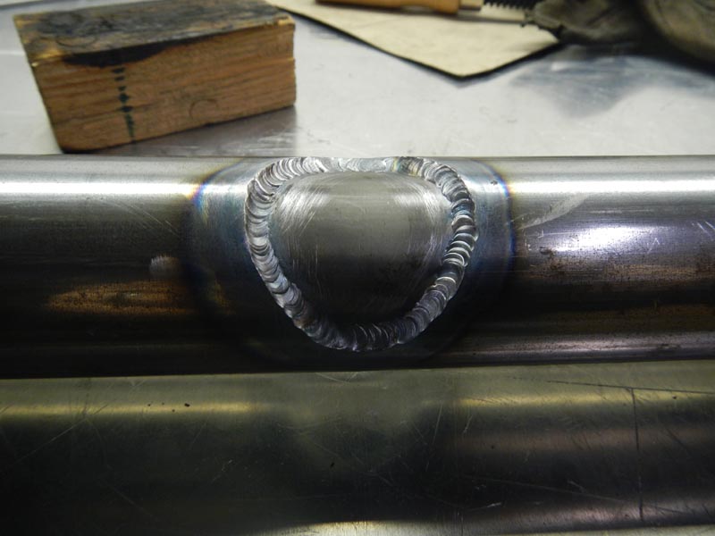

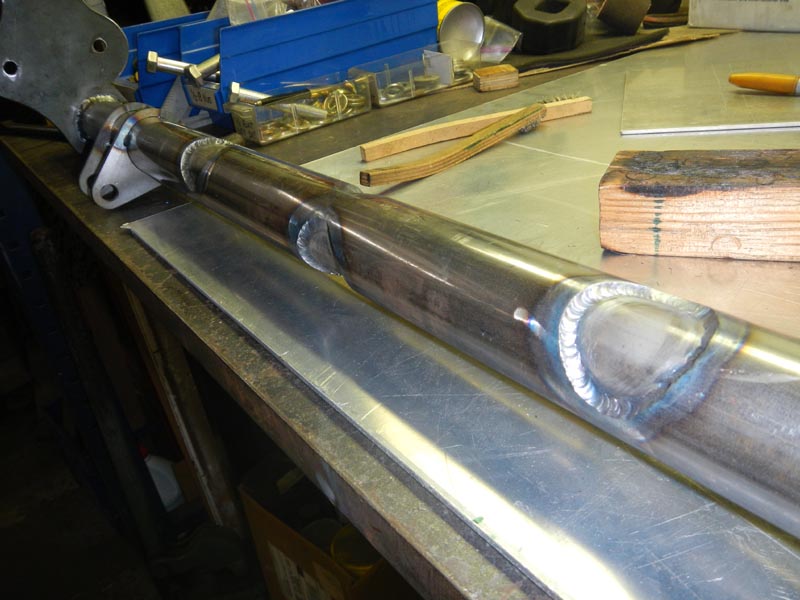

Any fabricator can make something like this for you.
My setup is a 1.5" x .120 wall tube sleeved in a 1.75" x .120 wall tube. It's probably overkill but with the mounts for the thing outboard of the frame (which my frame is 3" narrower than yours!) I figured the extra weight was worth the security of not bending it.
The upper shock mount tabs can possibly rotated up just slightly more than mine too, but not much. Mine are set that way for clearance on the fitting for the resi hoses.
Here's a couple more pics on the sleeving.
