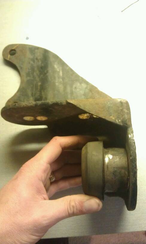

It looks like the fore and aft location of the front wheels will be easily remedied. Rather than cut the entire bracket apart, I think this will solve my problem with minimal effort and allow me to switch to the early model (f100's and such) radius arm bushings which work better with extended wheel travel.
Cut this little bad boy off the front and relocate the spacer to the front of the bracket.
Rather than reuse the piece of tube Superlift originally used, I'll have a friend machine me some spacers with a larger outside diameter.
The end result will look something like this:
Woohoo! Progress!

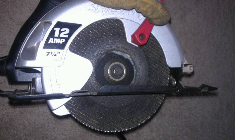

I'd forgotten how much of a pain in the ass it is to install the radius arm brackets. The frame is double-walled in some areas and even has a spot with 3 layers of steel. Getting fasteners in spots with enough flat surface to put a bolt is still a work in progress. The other chore is the contoured lip on the bottom of the frame next to the catalytic converter. A plasma cutter would have made quick work of it but I'm at home so I had to improvise. I think I've shown you guys this before but it works great so I'm showing you again.
Skill Saw with an abrasive metal blade:
Spot to be cut:
Done!

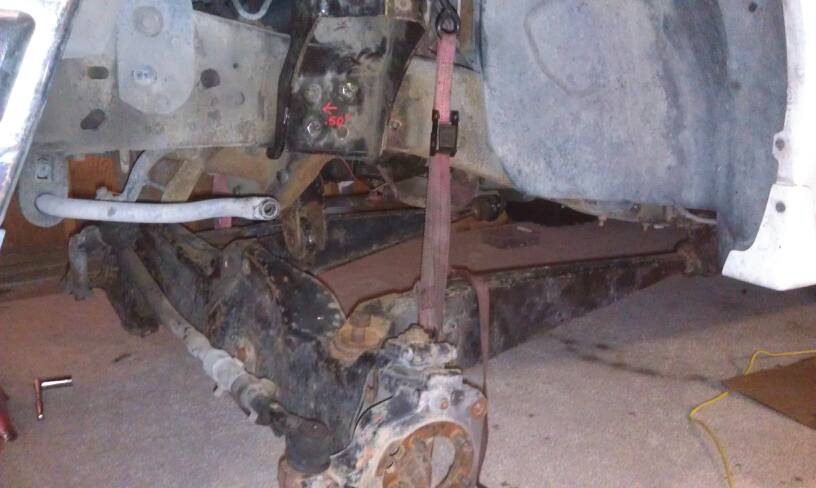

The front end is loosely bolted up and has been cycled. Moving the spacers from the rear of the radius arm brackets to the front worked out pretty well. The right side is pretty much dead on center at full bump. The left side is almost there but needs a bit more. I think I'll end up slotting the bolt holes on the coil-bucket to move the bucket rearward.

I know autofab favors the older style of bushings do they work better? My issue on my truck right now is longer radius arms with a lower amount of lift and stock radius arm brackets. Because the arms mount further up the frame normally the bushing is pointed down a little so the bushing is already binding at ride with the longer arms. I want to build some brackets like what you have to keep the bushing at a more neutral position. Do you have a pic of the brackets on the frame and how thick is the material. I don't want to buy heims
Re: The 8 Year Project
kylesgorter wrote:I know autofab favors the older style of bushings do they work better?
I think they might flex a little better but probably more importantly, they seem to hold up better to continuous cycling.
kylesgorter wrote:My issue on my truck right now is longer radius arms with a lower amount of lift and stock radius arm brackets. Because the arms mount further up the frame normally the bushing is pointed down a little so the bushing is already binding at ride with the longer arms. I want to build some brackets like what you have to keep the bushing at a more neutral position. Do you have a pic of the brackets on the frame and how thick is the material. I don't want to buy heims
I'll get some photos but in their current configuration, they're not the best examples. I would check Autofab's website for photos of their bushing arm pivot brackets... or the web in general.
Autofab's pivot brackets are designed so they are at zero-bind at static ride-height.

Getting closer. Checking full bump....
