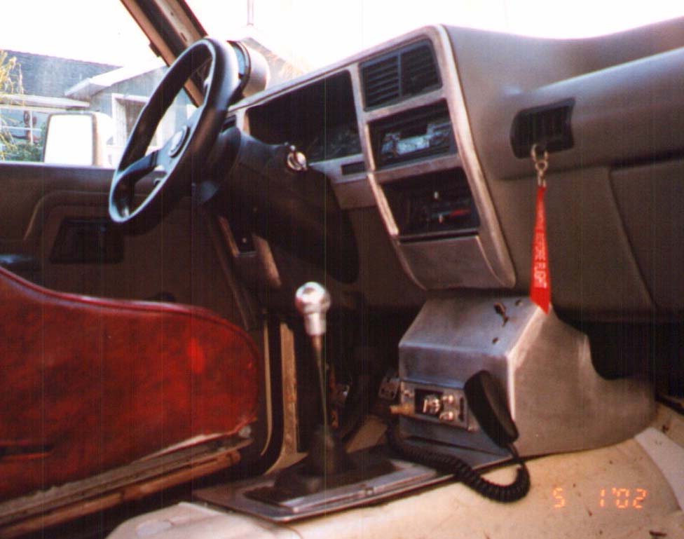

Not sure about the F-150's but on the rangers of this era the "wood" was a paint or coating over aluminum! So the "wood" trim piece around the dash, etc. was aluminum & stronger than the plastic type ones off the lower trim levels. A bit of time with a wire wheel and my ranger looked a bit ricier (ok - not a ricer, but still) but better than wood. I'll see if I can find a pic.crazyjim wrote:I'm slowly getting rid of the funky ass fake wood grain all over the interior of this truck, one piece at a time.
Oh - and those beards in the pic are on angle iron on the stock sliders - so yes, it does work well - haha
- CB holder.jpg (61.82 KiB) Viewed 2268 times
- CB holder2.jpg (64.16 KiB) Viewed 2268 times

Yea Steve mine are just shitty fake wood overlays. Looks like an eBay kit or similar. When I try to remove them they crack up and leave residue. My gauge surround is jacked anyway, just going to replace it.
