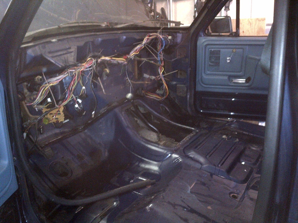

Project Snowball
So far most of my work has been focused on the cab as the engine parts are still coming in, and I want to do that all at once.
The truck at one point had dealer a/c, but it had been disabled before I ever got it. Not sure what was needed to restore, but I knew I needed to get at the evaporator. Combined that, with the desire to quiet the truck down, switching to a manual transmission, and atleast a few broken peices of trim I new the interior all had to come out.
I also want to run H4 style conversion headlamps, so I knew I would need to get at the electrical system. Looking at the wires I was disturbed to find 3 inappropriately used scotch-locks, and 4 cut / un-capped wires (2 always hot, 2 ignition hot). As a result I unwrapped most of the harness to trace them back so they can be fixed or eliminated all together.
After finding the floor-pan rusted from a leaky cowl last year, I also knew I had to do bit of repairs to the floor. Yesterday I twice over cleaned the floor with mineral spirits, and then twice over with POR-15 Marine Clean.
Here is how I left it last night -
The plan for tonight is to use POR-15 paint and Power-Mesh to fix up the holes in the floor, and rust-proof the pan.
