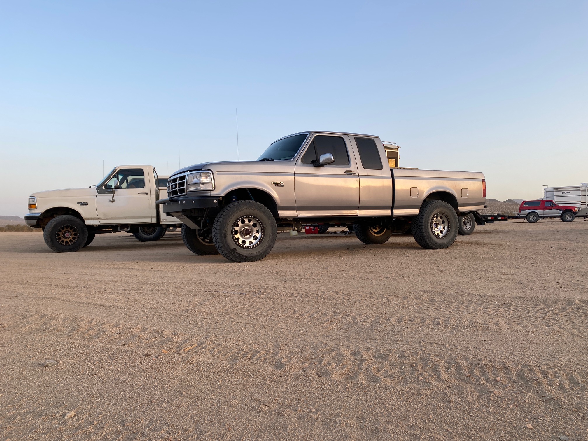

I took my truck out Friday with the new front end and was stoked on how well it did, wondered how it will do when king finishes my 3.0s and I can do a bed cage, and then immediately got out performed by a bunch of stock RZRs and Can Ams and finally wondered how nice it would be to just make the payment and drive something purpose built to take a beating and not have to stress
That was me at KOH 3 yrs ago when Vic bought his Rzr.......I saw him running through the big whoops and was Like WHHATTTTT THEEE FUUUUUUUUU.
So cool that your front end came out nice man, looks bitchen.
thanks Tony, at this point in the season, i will probably drive the truck as is, MAYBE get the bed cage done if Mikey from FabLab can squeeze it in, and then field some offers on it in the spring. I would like to do mohave trail this season, and possibly take the northern powerline road to vegas (well buffalo bills parking lot in primm is where it end) to the Mint 400 this year.

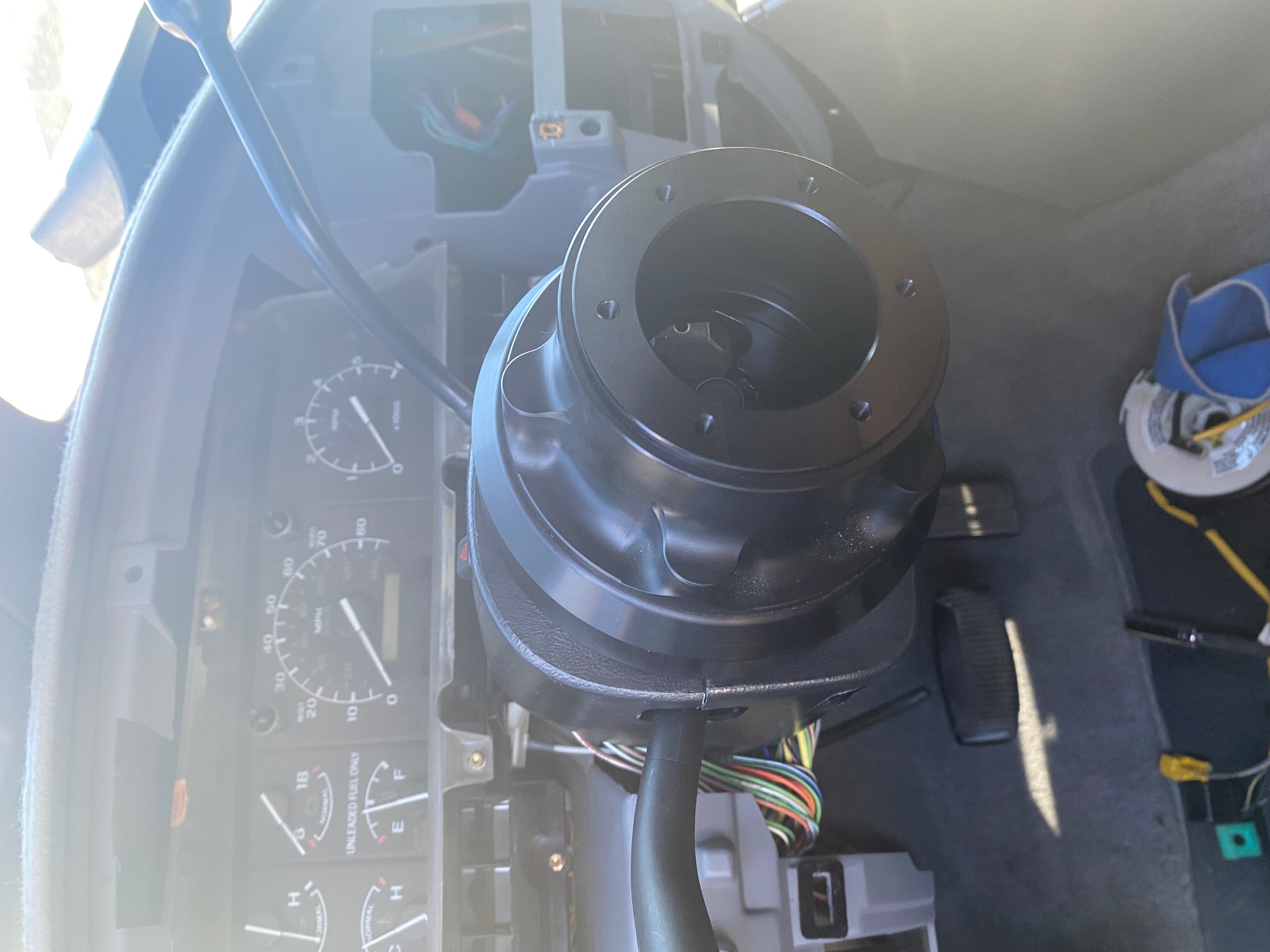

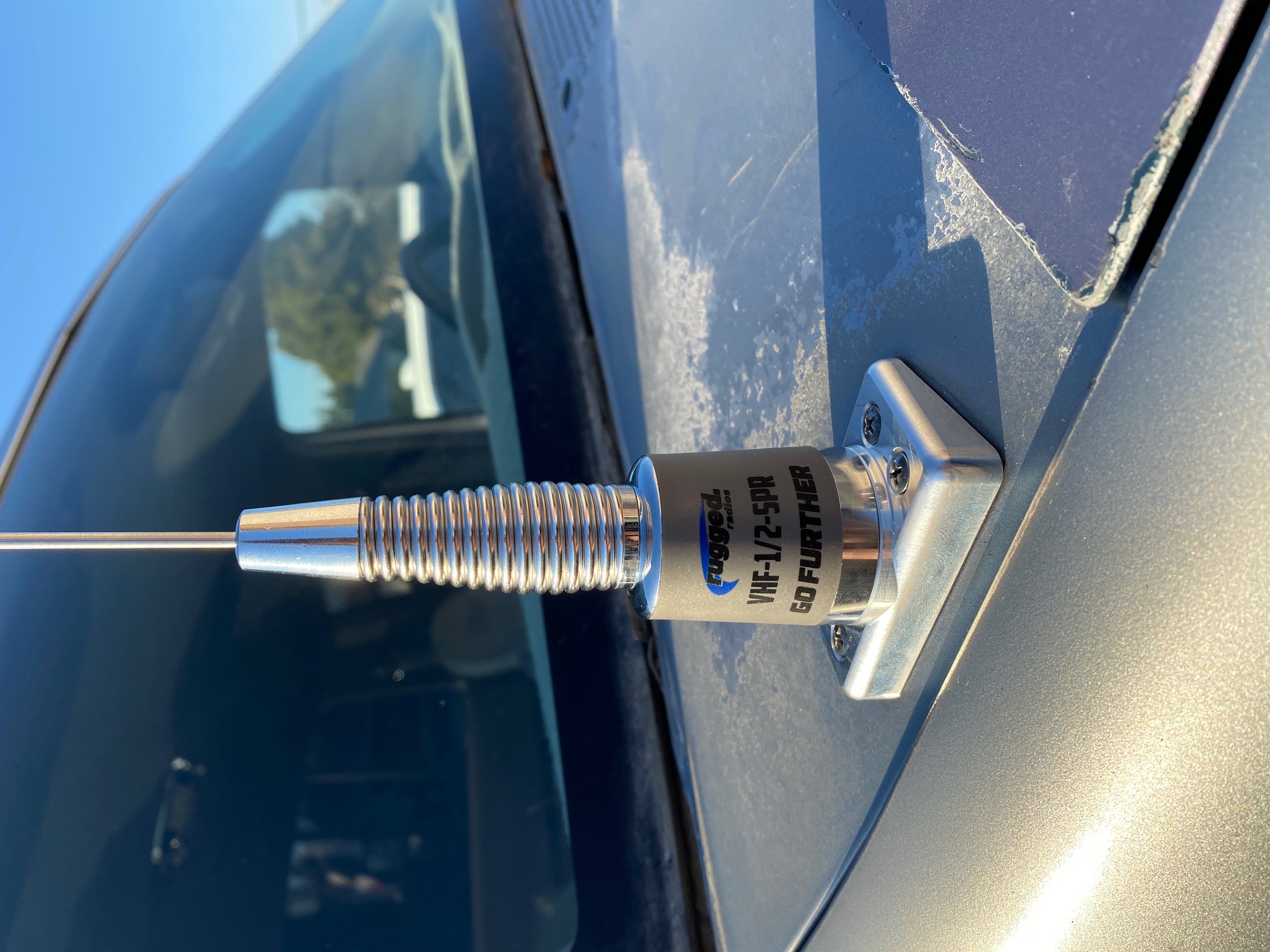

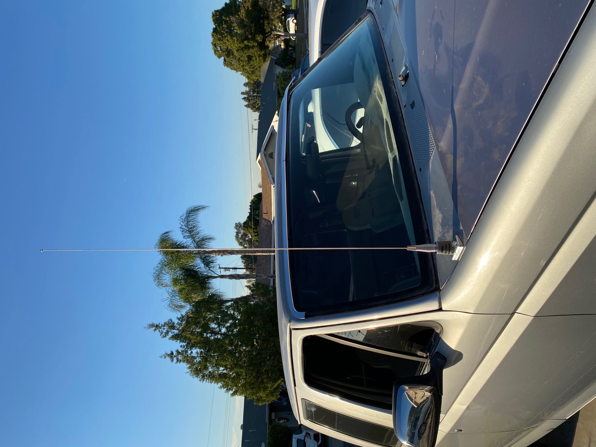

a couple little detail projects here and there lately, ran the rugged radios obs/bronco antenna since i dont care about am/fm radio, mounted my race radio in the cab, and started installing my new steering wheel QD and hub

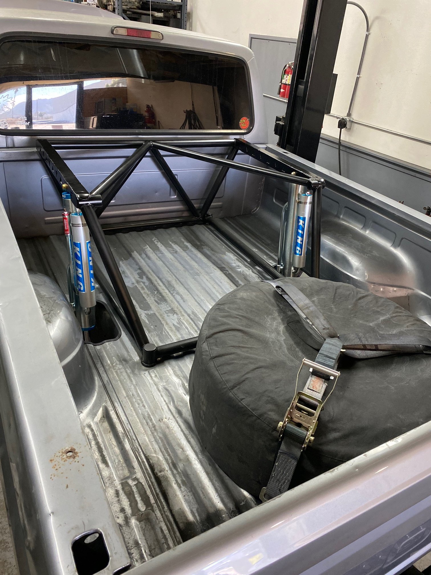

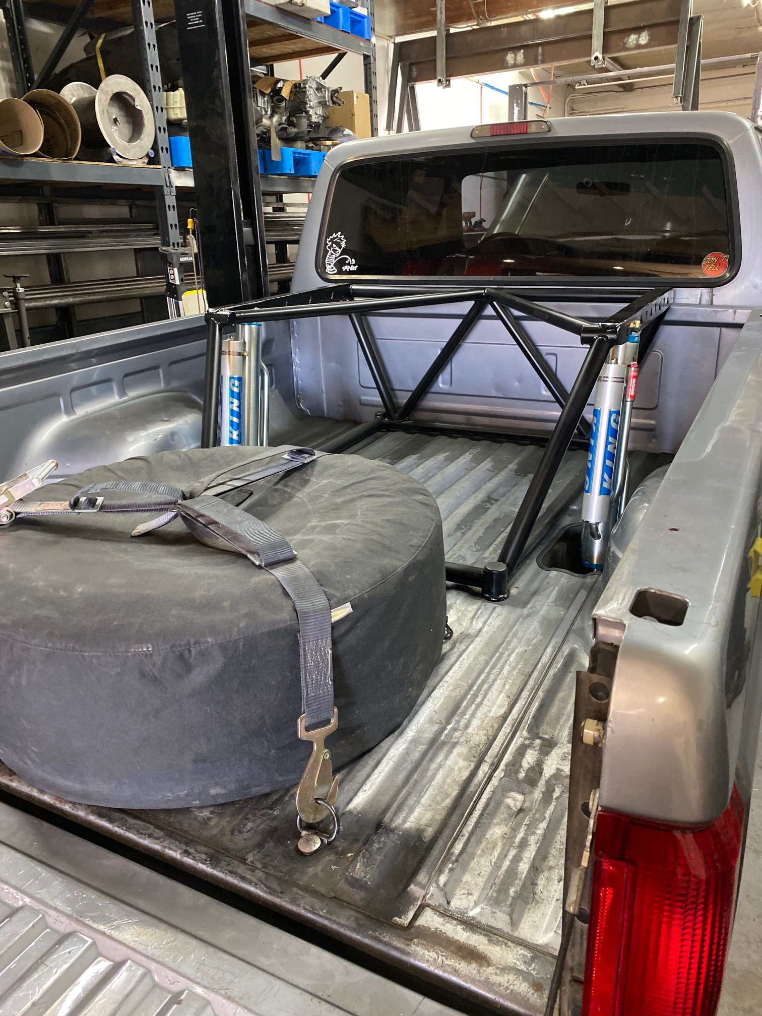

Shakedown run after the bed cage with Mikey, Bruce, Austin, Derek, and Dave Watts

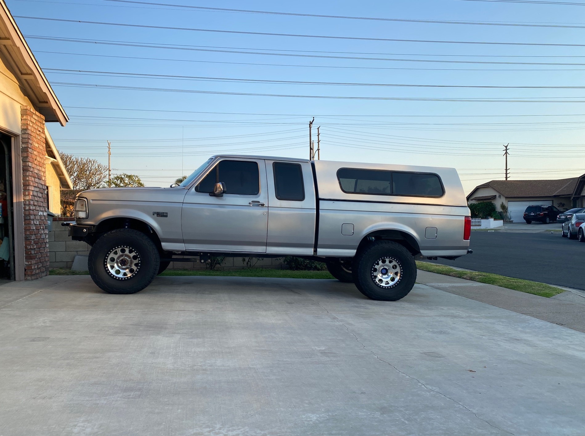

Scored a color matched shell for the price I sold my old one for..stoked!

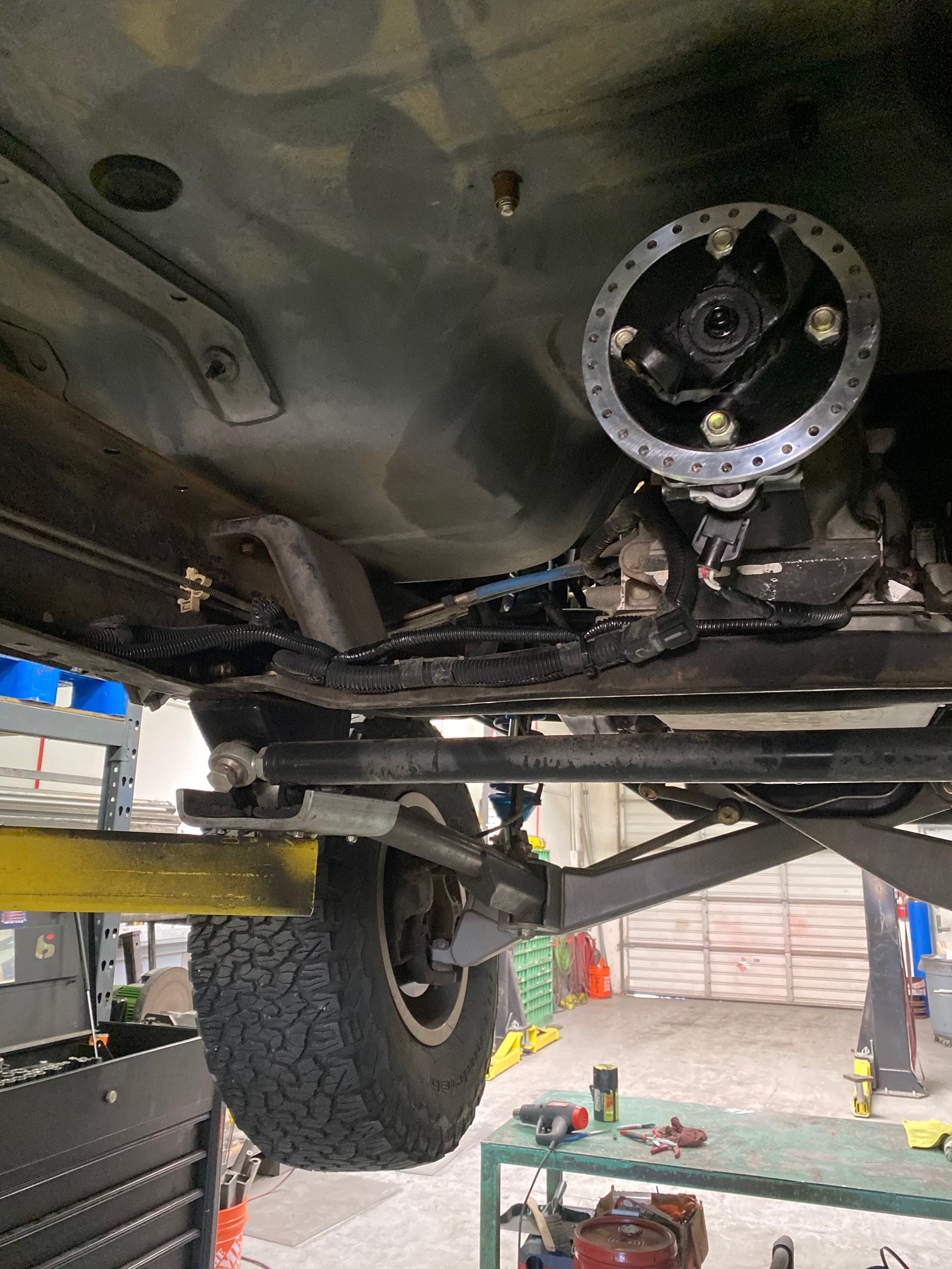

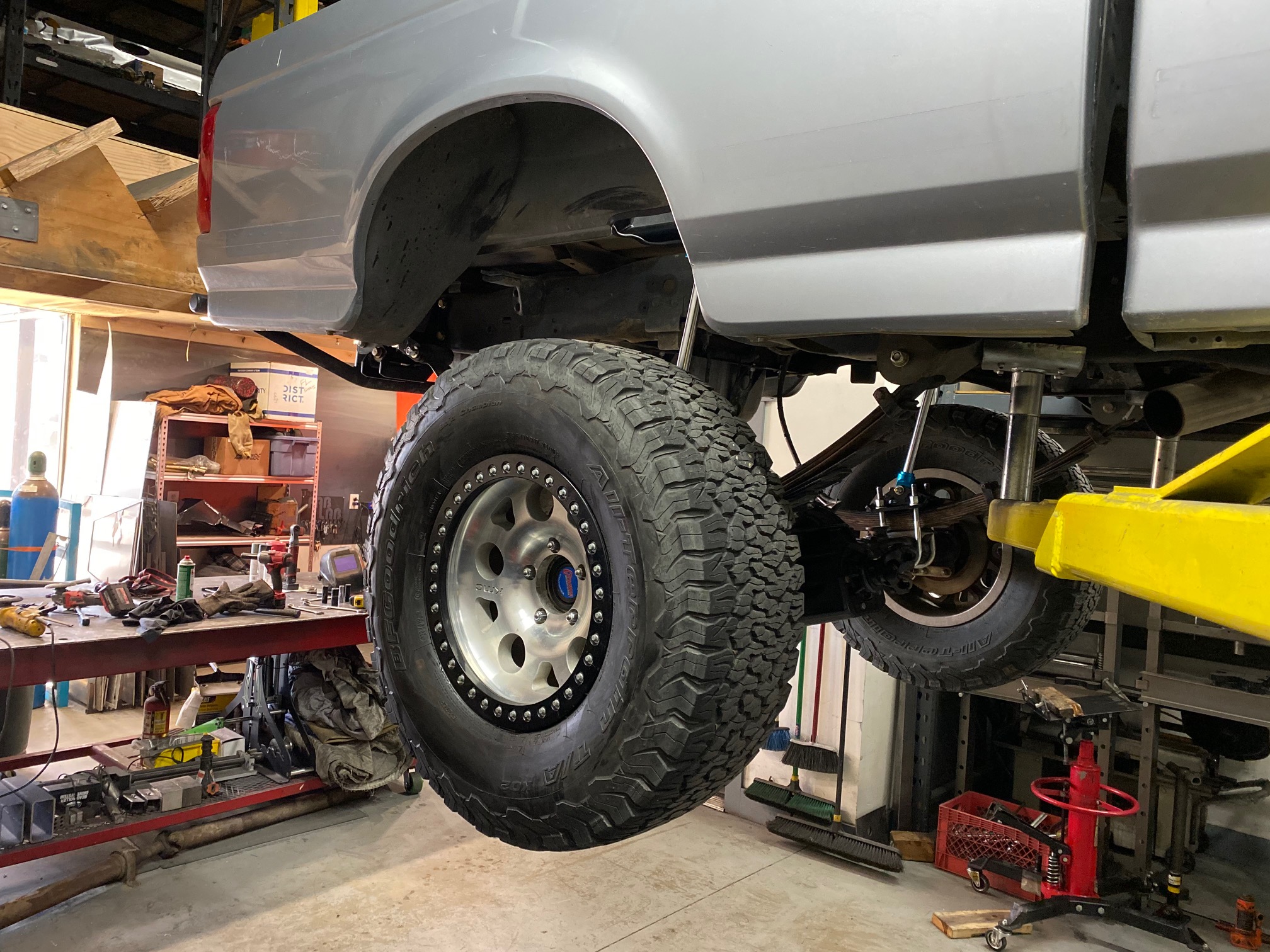

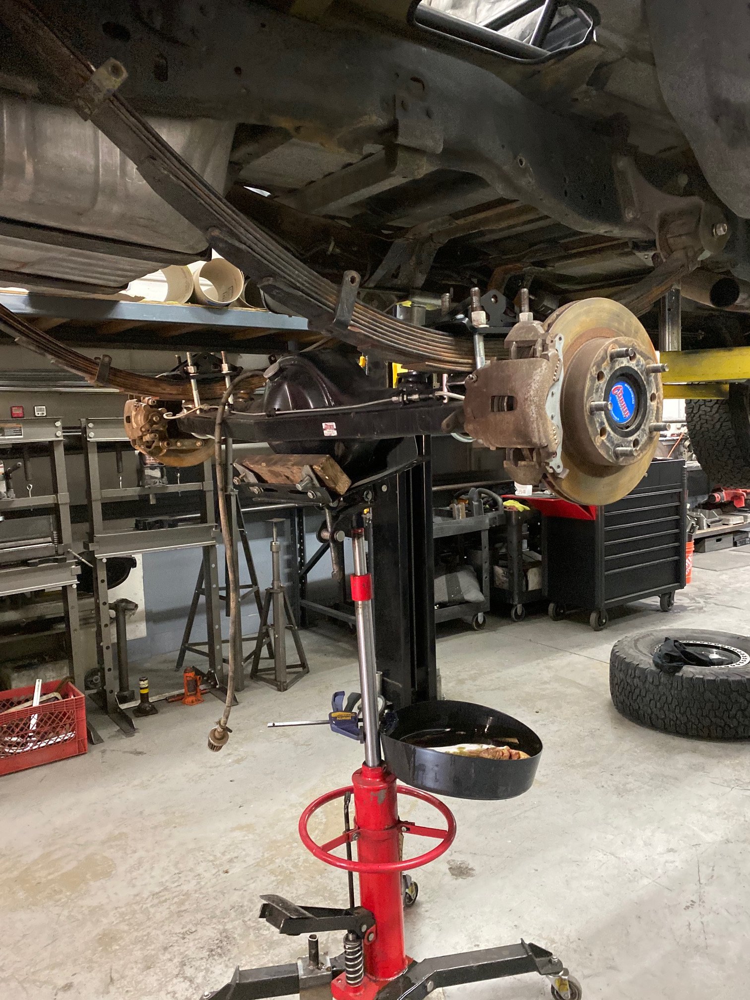

Rear end started clicking and clacking so I figured it was time for a rebuild, went ahead and stepped up to 35 splines, opted for a true trac instead of a Detroit this time, and added a wilwood dynalite kit

Which diff guard did you end up using ?
S00TLYFE
Posts: 1076
Bronco Info: IT RAPTOR NOW
Location: Buena Park
Re: 1995 F-150 Build
Post by S00TLYFE »
mgobaja wrote:Which diff guard did you end up using ?
I think this one is an old school Currie? It was on my axle when I bought it
