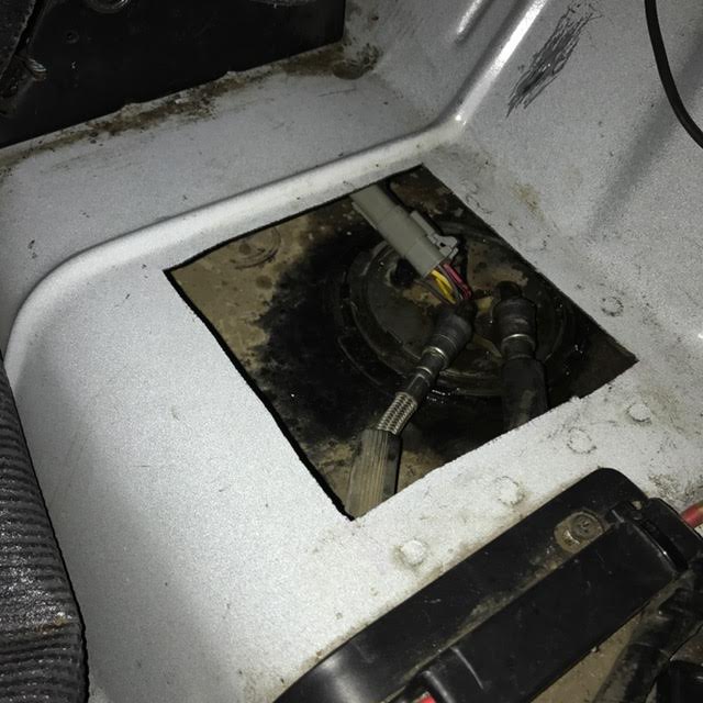

300 wrote:Hey Steve. Probably don't have to tell you, but check the impact switch. Can't tell you how much I have chased my tail with this one, and how many miles I have run with one bypassed. Being near the coast is hard on them. When it starts one time and not the next, it's suspect.
I should have noted that when I had to have it towed, it did start once and ran very rough, with no change when opening or closing the throttle. Also, it has recently bogged down a couple times in second gear under acceleration... all signs that point at a fuel pump or filter. I replaced the pump last night and the fuel filter tonight. The fuel out of the filter was damn dark so, even without any testing I'm pretty confident it was a fuel delivery problem.
Current state (not much to see, but it really does make this A LOT easier to work on):
Explorer Fuel Pump Access Panel (5).jpg (61.31 KiB) Viewed 1146 times

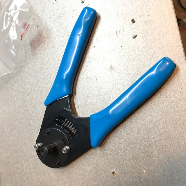

You can see the 4-way Deutsch connector I installed right at the fuel pump module. I have to say, I'm not a fan of things you can't buy everywhere, but Deutsch connectors really are growing on me. They're super easy to assemble and, generally, last the life of whatever you're attaching them to. In this case, they were perfect as I had very little wire to work with and the crimp tool is small and easy to maneuver is tight quarters.
The crimp tool:
Deutsch Connector Crimp Tool.JPG (132.32 KiB) Viewed 1146 times
