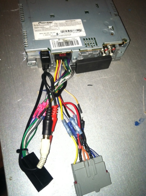

I did make a good upgrade tonight and it was super easy, too. I have an old Pioneer deck in the car. It works a and sounds good enough but has no aux port on the front and certainly no Bluetooth. Until now! I installed a Bluetooth module just a few minutes ago... relatively easy install. Remove radio, solder into ground and switched wires, connect to RCA jacks, stick on back of radio and reassemble. Only about 25 minutes worth of work and a no more plugging in every time I get in the car. At the moment I still need to manually connect (not pair) with the Bluetooth module but I think I can make I automatic in my phone.
