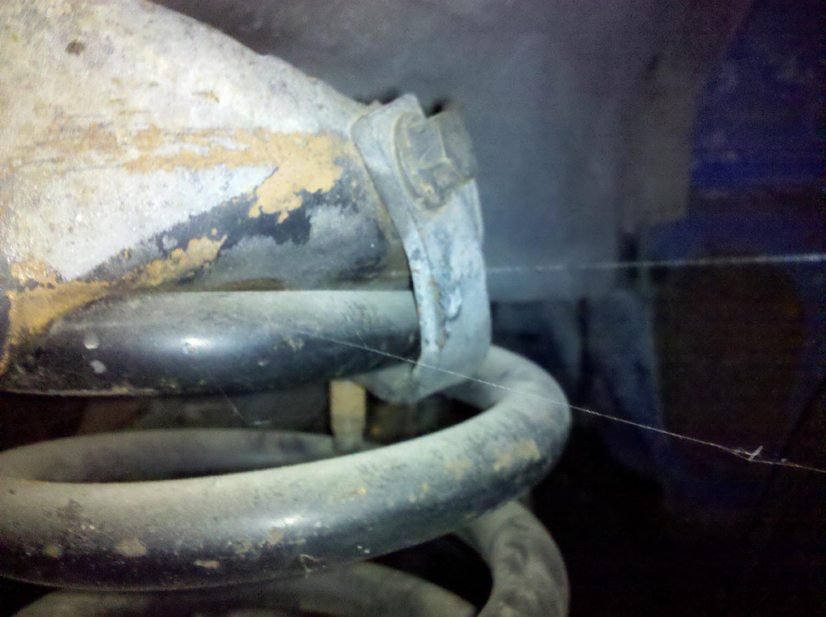

I need a little help with figuring out what I got goin' on here. The coils seat in the buckets perfectly and there is space between the coil retainer and the coil. Everything looks great until I start lifting the I-beam and coil slips out of the bucket up into the retainer hook. Im still "blind kid" fumbling my way through this suspension since its my first 70's Ford build. Whatcha think Im doing wrong? Am I missing any other parts to keep the coil seated? Im starting to think I have the wrong retainers.

Re: My '77 Project
Are you sure you got the right coil clips? The bottom of those ones with the little indents clips into something if I remember right. I just can't remember how they work off hand. I can look around & see if I can figure out what I did with the ones that came off those buckets. They're around her somewhere for sure.

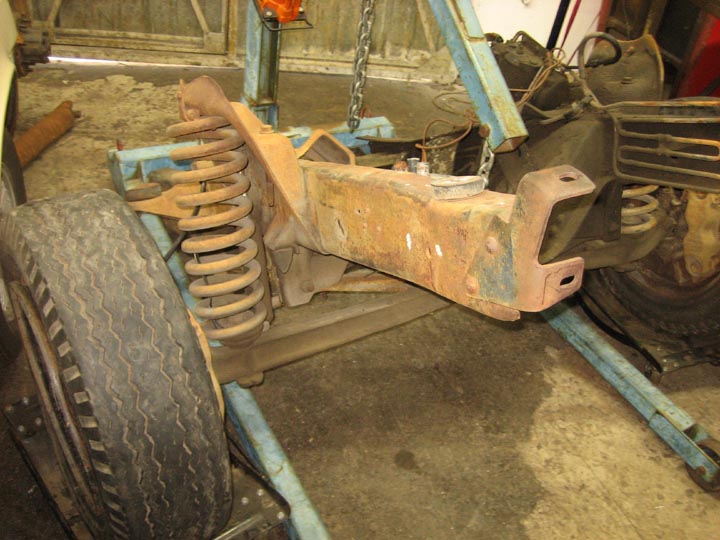

Until then - here's a pic of those buckets in stock form. You can't see much, but you can see there isn't a gap there like you have. I have a buddy with the tall coil buckets & I just hit him up for a pic. I'll post it if I get one.

Does it looks like the coil bucket is bent? Are both of the buckets like this? The face that the retainer bolts onto has been vertical or plumb on the trucks I have worked on, 2wd and 4x4.. Yours looks like it is leaning back, it may be bent.
Those clips have two notches that slip into a grove on the coil bucket. They go in the groove and then the bolt is installed. They are supposed to fit snug when installed.

Ive come to the conclusion that they are the wrong clips. Theres nothing for the notches to clip into and they dont keep the coil in place. Jason, the coil slips out under compression. As soon as I get it under pressure, POP! John, coil buckets are good, both are exactly the same. I think my problem is the coil clips came of off a 77 F150 and the coil buckets are off an F250. I gotta get the right parts for the right job! This is how I learn I guess....haha

Coil buckets are good. They are the EXACT ones in my photo as I gave them to Chris.johncharlesb wrote:Does it looks like the coil bucket is bent? Are both of the buckets like this? The face that the retainer bolts onto has been vertical or plumb on the trucks I have worked on, 2wd and 4x4.. Yours looks like it is leaning back, it may be bent.
As for the clips - they do tuck into a slot in the bucket & the more I think about it- I think the hole for them is kinda up above the top wind in the coil. I seem to remember them being a pain to get out.

Yeah, I did not realize those were F250 buckets. They are definitely shaped different. Do they take a different spring? Napa lists a F250 as a 4" ID spring with two pigtails, while a F100 spring is 6" ID tangential/pigtail.ChaseTruck754 wrote:Coil buckets are good. They are the EXACT ones in my photo as I gave them to Chris.johncharlesb wrote:Does it looks like the coil bucket is bent? Are both of the buckets like this? The face that the retainer bolts onto has been vertical or plumb on the trucks I have worked on, 2wd and 4x4.. Yours looks like it is leaning back, it may be bent.
Those are F100/F150 retainers. The hole is hidden by the top coil and they bind up if you push them down too far versus sliding them back out of the slot. They are one of those taking your time is the fastest kind of things.
Re: My '77 Project
These are the "tall" buckets found on the heavy duty trucks - typically F-350 trucks, crew cabs, etc. These came off a "heavy duty" F-250.
The F-100/F-150 & light F-250 coil bucket looks like this.
The coil retainer looks like a mount/bracket for mounting conduit to a building. It has a half circle with tabs on either side and bolts to the bottom of the bucket up inside.
The coils are different on the "tall" buckets & shorter ones. The "tall" buckets have a half wind on top like the big broncos do. The shorter bucket trucks have a coil that stops just like it was cut - meaning now short/tight wind across the middle.

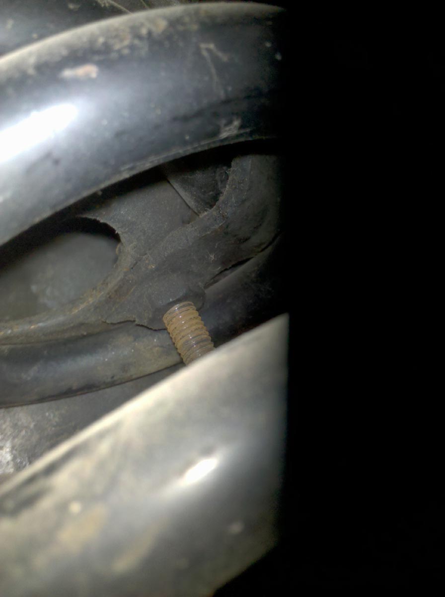

Chris - I emailed you these pics, but I'll post them here in case anyone else is watching & might need this info.
These are the pics my buddy took of his F-350 crew cab which SHOULD have the tall coil buckets. I can't really tell in the pic though. Check the clips on these & how they bolt both top & bottom. I can't remember if the clips on those buckets I gave you did this or not - but have a look at them & you should be able to tell if these would work...

Thanks again Steve. This is gonna help a lot. Im thinking because the radius arm brackets I pulled off the same frame chunks didnt fit my frame for the same reason, F150 vs 350.
