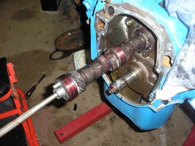

New Comp Cams going in:

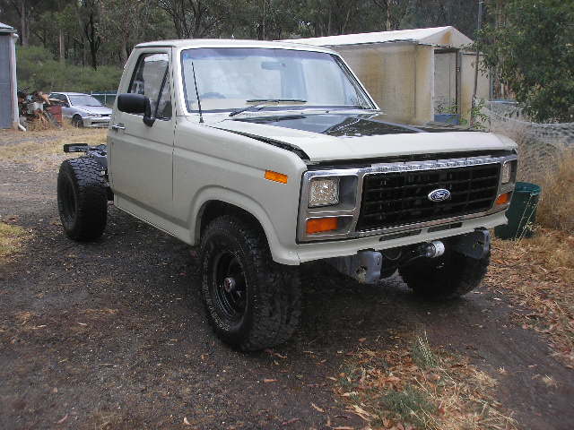

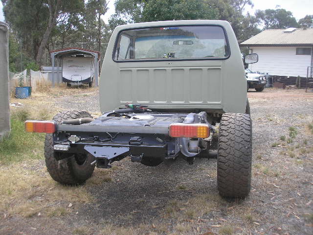

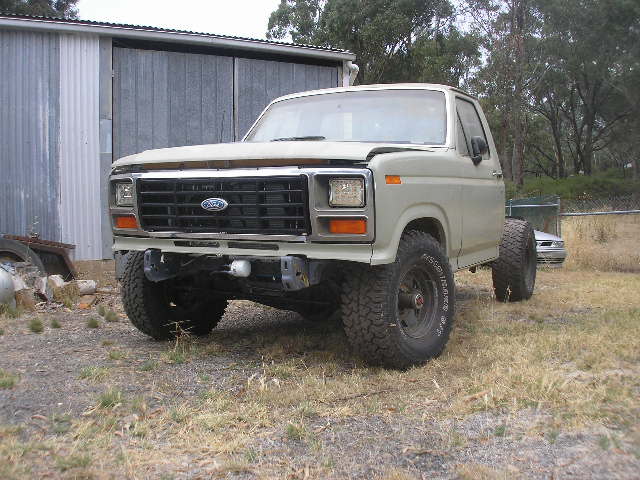

I didn't get any pics of the engine going back in, but here she is, outside the shed for the first time in a YEAR under her own power:
I even gave it a wash (first time in 2 YEARS):

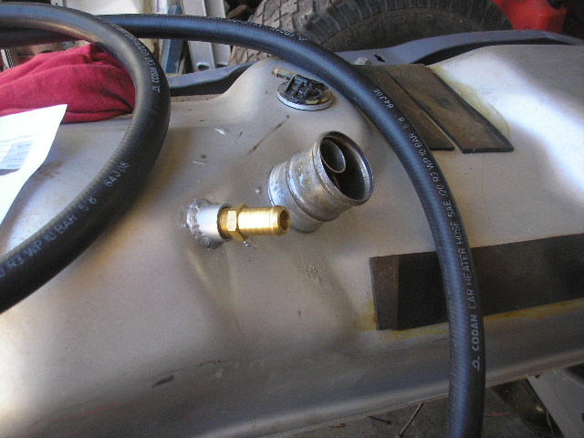

Fuel tanks out, to modify the vent breathers on the fill tubes:
For some reason, the US style filling system won't work here (for me, anyway). So, I hole-sawed out the unleaded restrictors AND the internal hoses from the fill necks and welded in a 3/8" NPT bung just below the filler cap threads. I also welded a bung into the top of the front tank next to the filler neck.
Posts: 2811
Re: Rod's 84 BabyBajaF100

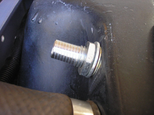

I've put in a brass 3/8" NPT to 5/8" hose barb for the vent hose to go up to the top of the filler tube (front tank).

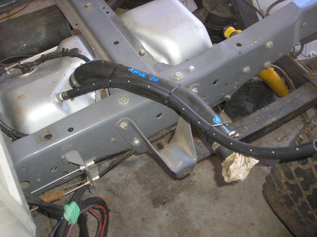

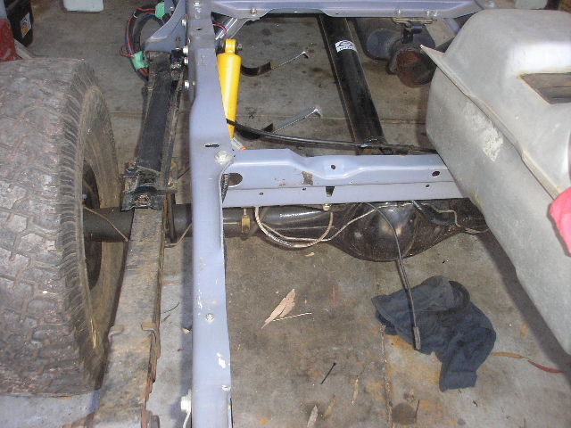

The rear tank I'd made an insert-able fitting, to fit without removing the tank. Once the fuel pump/sender is out, I can just get my arm in enough to put this in, but I removed the tank and did this at work on the bench.
This is some of the rubbish out of the front tank after I emptied the last fuel into a large bucket.
Front tank vent and filler hose fitted (hopefully for the last time).
Rear tank vent fitting fitted. I'm considering a 38 US gal fuel tank for the truck at a later date, so i'll need to make the straps up for it and get another fuel pump/sender to modify for the deeper tank. I made this in the lathe from a M20 8.8 metric bolt and nut. It took far too long, but it's done the job.

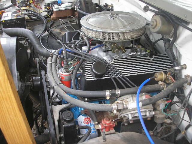

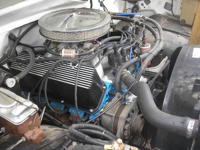

I picked up 2 of my plastic fuel cans with 22 litres of our 98 unleaded to put in the tanks. I used about a litre in each to rinse and flush out any dirt and shavings from the vent fitting going in and then poured 1 each into their respective tanks. The new fuel made it idle better, although the Edelbrock carb isn't in the idle slots. I can tell because I can close the idle mixture needles right up and it barely makes any difference to the idle quality (which is shit anyway). I have a new Holley 600 vac on the way to replace this junker. A couple of pics of the Clevo as it sat this arvo after I ran it:

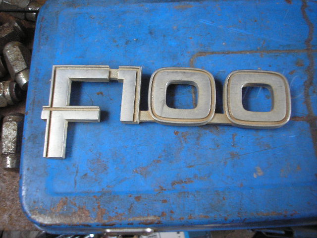

If anyone has a couple of these fender badges, let me know:
I'm having a hard time finding them, new or second hand. Let me know and we'll work it out from there. I still have to pull the leaking PS pipe and re-braze the fitting on, but I'll do that tomorrow night. The truck just needs a 1/4" tee in the tank top vent lines to connect both to the charcoal canister and a couple of 90 degree 3/8" NPT to 5/8" barbs for the filler tube vent bungs. They'll get re-tapped tomorrow at work. ( They shrunk a little when I TIG-ed them in last week.) Once that is done, the tub is going back on and I'll start driving it to work to build a bed cage for it after hours.
