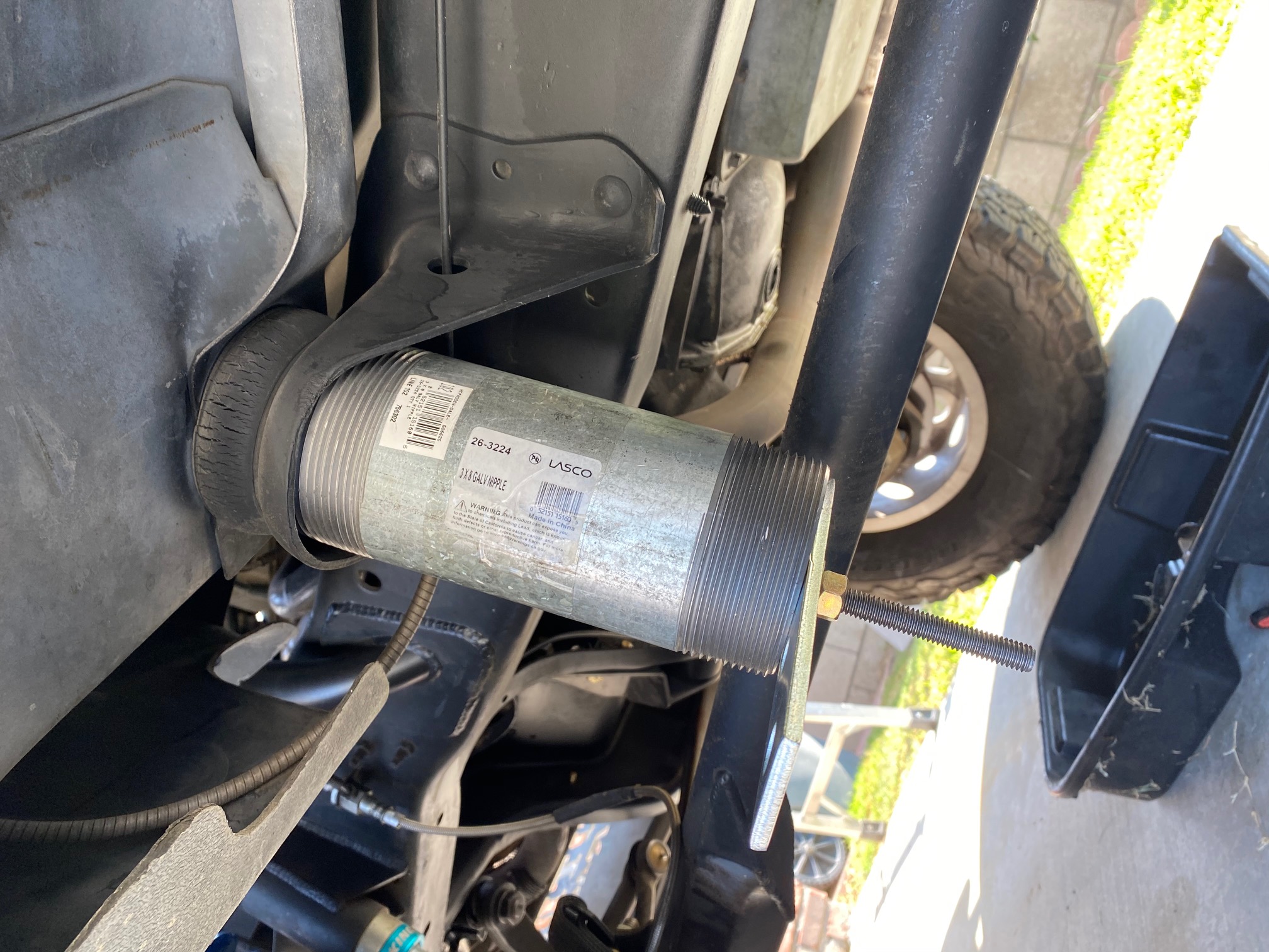

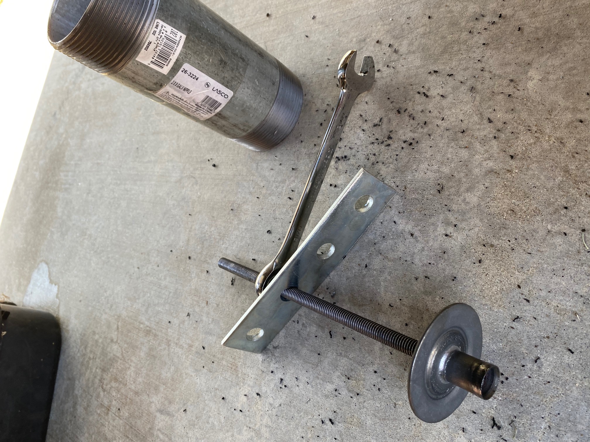

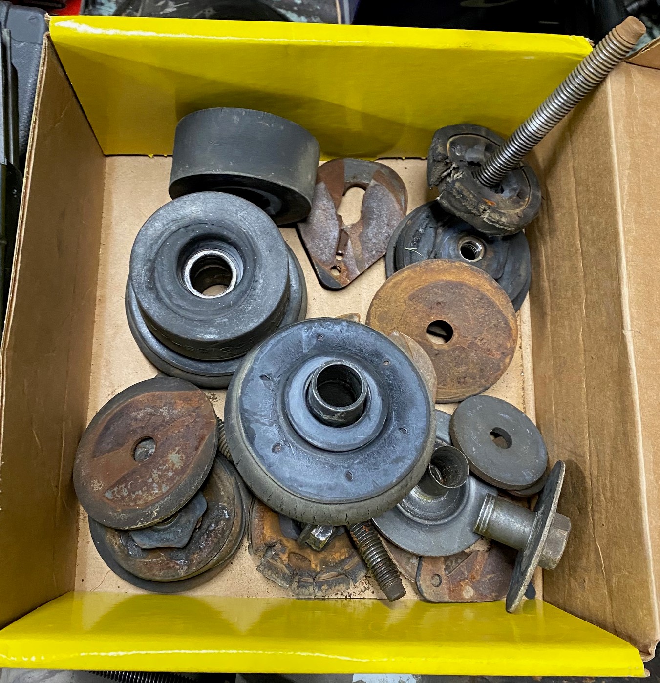

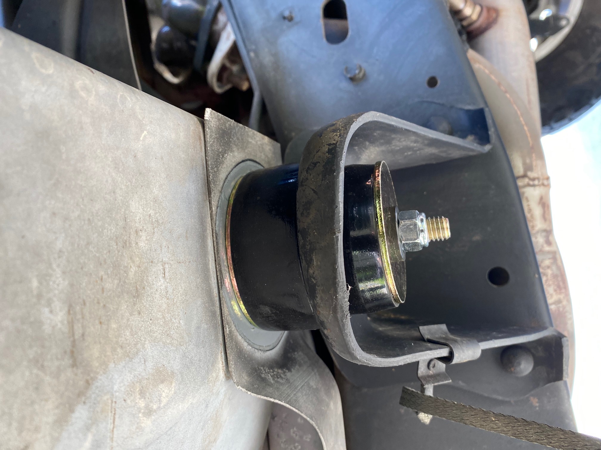

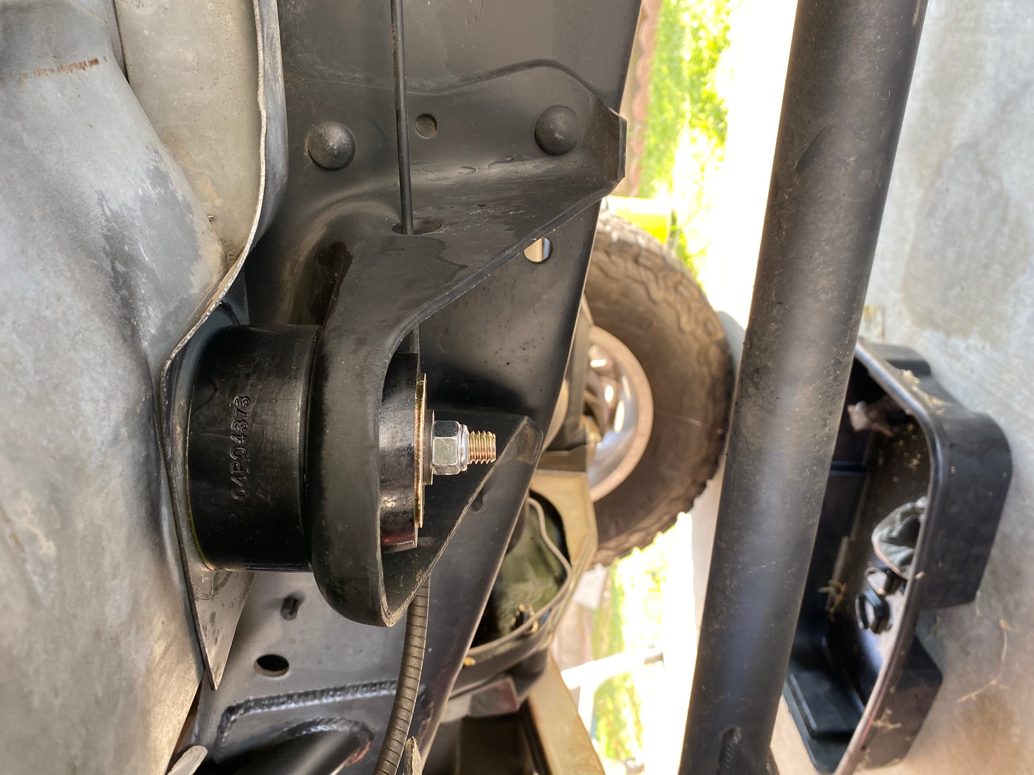

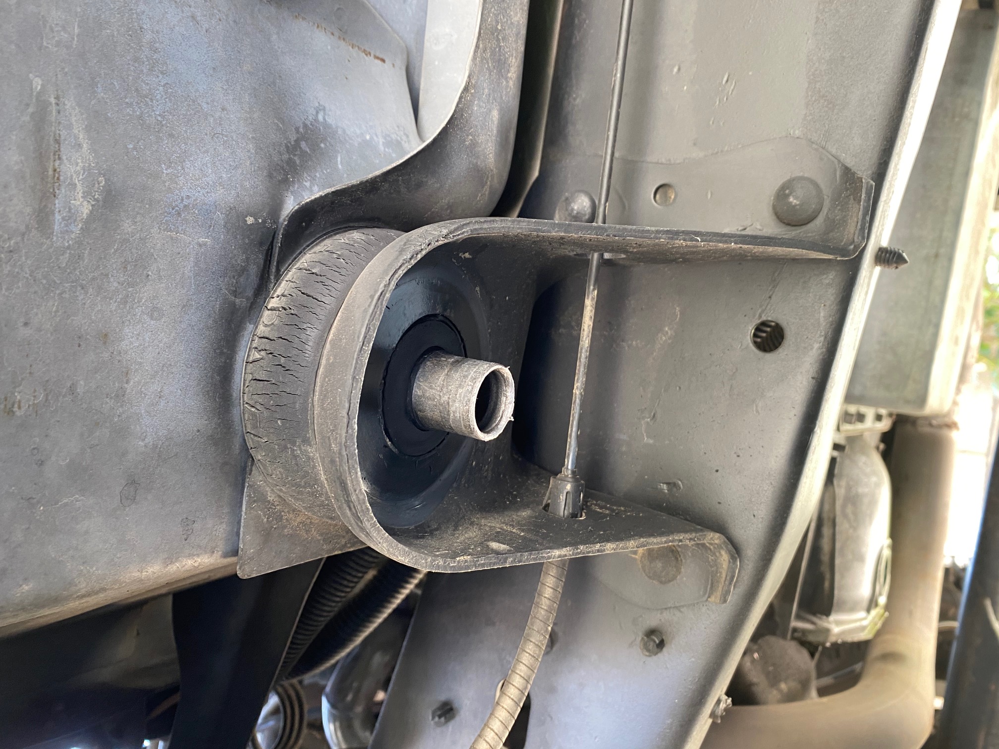

finally decided to tackle my body mount bushings, for those of you wondering, its not bad if you have a 1/2" impact, and you can make a puller very easily out of readily available parts from your local hardware store. I used 7/16" coarse all thread, a nut, a washer, a random piece of plate i had, and a 3" by 8" piece of pipe, and it worked like a charm. I was able to get the four front ones done pretty quickly but ran out of time, I will tackle the final 2 sometime this week after work.
