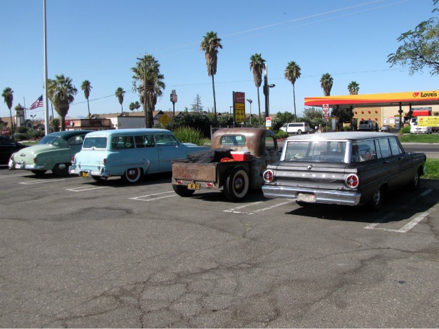

Whew! The family and I logged about 650 miles in the Falcon this weekend. It performed flawlessly! No hiccups whatsoever. The car drives sooo much better with the front end lowered. I asked the alignment tech at work to set toe on the front end last week but being the perfectionist he is ,he adjusted all the angles and even tightened up the gear box. It feels freakin' great and I'm glad he did! It's manners on the road are just great. The car is a pleasure to drive.
We drove to my parent's house in the central valley then caravaned to Antioch with my older brother and his family in their 54 Plymouth 2-door wagon, my younger brother and his girlfriend in their 63? 2-door Falcon, my parents in their rat rod and some family friends and their family in their old Buick (can't remember what year it is). The Billetproof show was fantastic. I hear there were about 1000 cars but somehow the coordinators still manage to make it feel like small town show and like everyone is welcome.
Can't wait till next year!

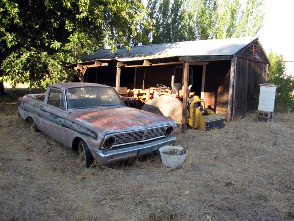

Funny you say that. It appears I'm saving a car from the scrapper. I somehow got talked into this Ranchero this weekend. Now I need to figure out how to get it here (or at least to the valley) from Brentwood.300 wrote:Saw a 65 2-door Falcon shell being towed behind a truck load of junk the other day, obviously on its last trip on its own wheels, on the way to the scrapper. Really, really thought about chasing it down.......

Ha! I checked those out while we were there. No bees to be found....300 wrote:Was going to say sure, no problem, then I realized that those are bee hives on the right side of the picture! I know a guy with a trailer...... V8 or 6 cyl car?
It's a 6 cylinder car but the owner put a V8 in it. He says it's all connected but he got busy with life before he ever drove it with the V8. We were really short on time and had people waiting for us, so I didn't get to spend much time looking at it but it sure looked like the conversion was complete. Overall it seemed like it was in pretty good shape. Some rust, but nowhere near ready for scrap.
