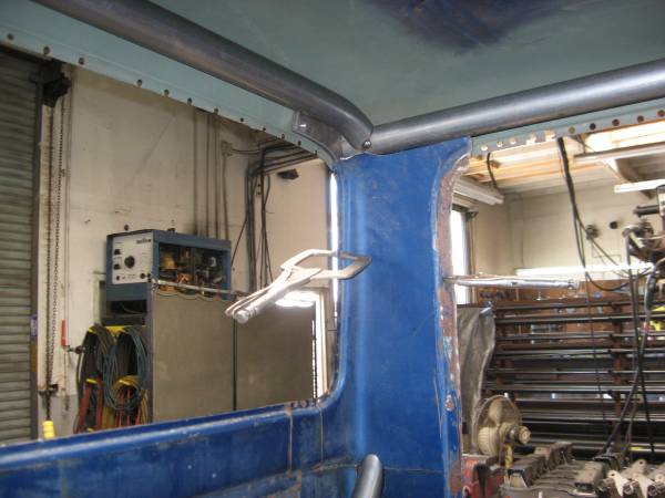

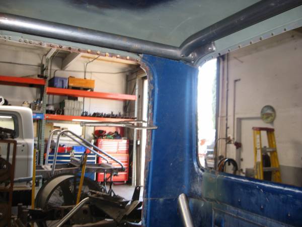

Main rear hoop taking shape, tubes are only tacked at this point and interior skins are just to get and idea of the fit.

Re: "Oldbaja"
Love the tubes tucked behind the panels like this!
Re: "Oldbaja"
So the verticle bar is inside there? Under the blue?
Re: "Oldbaja"
Autofab delivers yet again... Im noticing a pattern 8-)
Re: "Oldbaja"
Rmc wrote:So the verticle bar is inside there? Under the blue?
yup.

Re: "Oldbaja"
Post by Seabass »
Secsay! Wondering if thats doable on the bronco...
Re: "Oldbaja"
with a 2" tube - not sure, but I don't think so. 1.75" tube is a maybe as well from what I remember seeing when cutting the ones up I've had.
I got close with a 1.75" tube at the b-pillar of the ranger, but it was doable at the back of cab (it was an ex-cab).

Re: "Oldbaja"
Post by squirelmurphy »
From the looks of it, there is quite a bit of difference between the bumps and dents. The crown of the roof, and the space above the doors is what allowed room for 2" on my truck. On my 73 the tube sits above the door jamb. I don't think the roof is as tall on the earlier trucks, though.
That said, who gives a crap about 1/4" of tube? This thing is looking bitchin'.
I'm totally stealing the hood snubber thing, too.

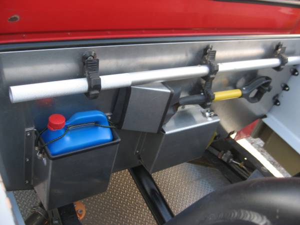

Front Bedside mount with pockets for Coolant,Shovel,Tow Strap & Jack Handle

Re: "Oldbaja"
Quailhunter wrote:Front Bedside mount with pockets for Coolant,Shovel,Tow Strap & Jack Handle
VERY nice!

Re: "Oldbaja"
Post by C H O »
ChaseTruck754 wrote:with a 2" tube - not sure, but I don't think so. 1.75" tube is a maybe as well from what I remember seeing when cutting the ones up I've had.
I did a 2" tube on the lightning behind the b pillar without cutting the sheet metal it was a major PITA, sure it's doable on a fullsize bronco but I dont think it's worth it..
