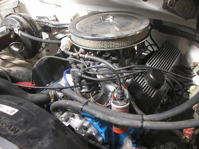

It lives again. After assembly (I forgot to take photos, of course) and the install in the truck, it started on the second turn of the starter and ran, no knocks or clacks. I topped everything up, made sure I had the hose handy and after pushing it out of the garage, started it up and started the cam run-in. All ran sweet, until about 10 mins in, it was getting hot and the hose could barely keep it cool. I shut it down and waited a couple of hours to re-run it. This took the best part of the afternoon to complete, but once done, it idled nice and oil pressure was good, etc, but the temp just kept climbing. Only a lot of spray from the hose and a fast idle would keep it down close to the half mark. It seems, as I already suspected that the brand new Dayco fan clutch was a complete dud and would not engage when the temp got up. I quickly ordered a Truflow one from ebay and it arrived pre Christmas, but I didn't fit it until Saturday. Are-run to check the timing exposed a loose rocker, which I suspect is a sticking lifter. I removed the valve cover, found the loose rocker and readjusted it, buttoned everything back up and the noise is gone. However, it still intermittently taps, so I'll need to go run it out on the road before I start any remedial work required. There is a small oil leak at the back, but it will have to wait. I suspect either a gallery plug needs tightening, possibly I need to reseal the main cap, or I put half the rear main seal in the wrong way. :? I'll deal with that when I have to. The new fan clutch works a treat, now the new larger fan really moves the air through the radiator at idle, and so far it stays under half.
So, the new engine specs are:
Speed Pro 0.030" 0/s hypereutectic flat top pistons and moly rings, Elgin RV cam, roller thrust rollmaster chain kit, Powerbond steel balancer, Milodon/ARP main studs with Milodn windage tray, ARP rod bolts with closed and resized rods, Melling HV oil pump, Milodon oil pump driveshaft and Milodon pick-up, home made oil pan (8 quarts). The cylinder heads were done by Flowcraft, with 2V single groove valves, bronze guides, HD srings, CroMo retainers and machined locks. The bowls, short turns and valve guide bosses were massaged and ported, along with the port roofs raised slightly. There are hardened seats fitted as well, for propane use. The heads are topped off with the Crane stud conversion kit and roller rockers. Speedmaster valve covers top off the heads and a copycat Air-gap intake covers the valley. The casting was very nice and all the holes, surfaces etc were well machined. I fitted a Milodon 'Hi flow" water pump as well. What a rip-off that was. :evil: :evil: It is just an el cheapo GMB pump with a plate welded over the impeller blades. Apparently, that's what Milodon calls a 'hi-flow' water pump. I painted the engine Chrysler blue. When warmed up, it cracks like a whip, so it should be a good, torquey street and off road engine.
The AOD is pissing me off. Every now and then (too often for my liking), I have a box full of neutrals and it takes a good stab of the throttle in gear to get it to wake up. I'm working on finding another NP435 for it, with all the required bits and will sell off the AOD. The fluid level is fine, any more and it leaks from the vent pipe. It's just annoying, and my gut feeling is that it will let me down out in the middle of nowhere when I least expect it, so it has to go. Otherwise, it's good.
Engine shots:

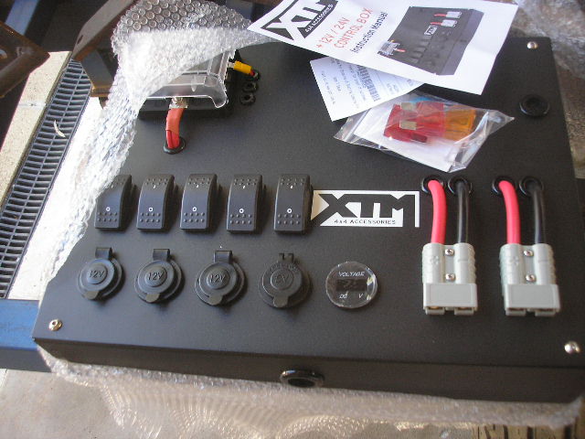

I also have this power distribution box to fit in the tub for power:
It also comes from XTM. It was on special, and with my member's discount, I couldn't make this for the cost. I just need to fit the front bar, weld on some tabs for a cover plate and it goes off for blasting and powdercoat.

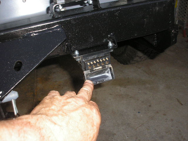

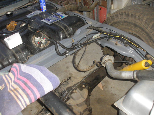

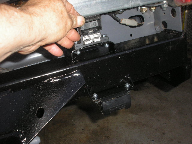

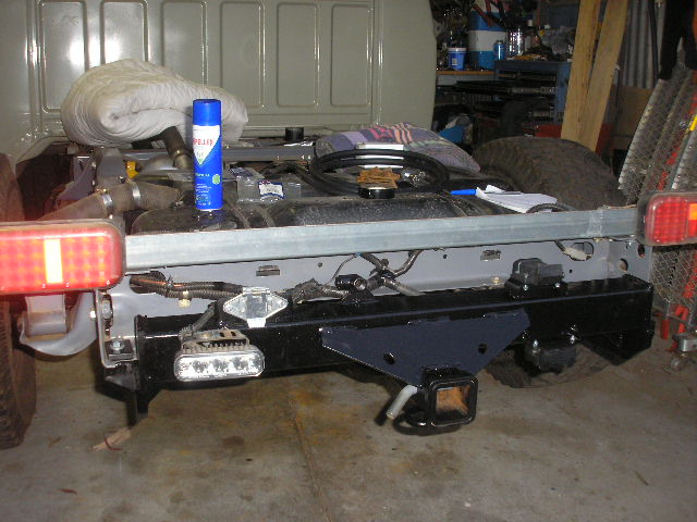

As for me, I've been spending my spare time getting a lot of the little things done to finish the F100. I cleaned up and painted the original tow bar hitch and today, I bolted that back on. The plugs and other fittings have been re-installed, ready to be used once it is drive-able proper. On the weekend last, I re-installed the rear fuel tank after removing the pump and checking/cleaning it inside. It has been re-plumbed back as the primary fuel tank, with the Carter pump on the frame rail still running in tandem with the in-tank pump. That way, if either one decides to fail, the other will keep me going until I can replace the faulty one. I'll carry spares of both/all, so I can stay mobile regardless. The tail pipe was also refitted, replacing the dump pipe in front of the rear axle. I'm just waiting for the new transfer pump(s) for the front tank to arrive, then once it is installed and I verify everything works as it should, the tub will be prepped and go back on.
Rear tank installed:
Tow bar hitch installed:
Reverse light and extra plug for the new trailer to control the propane tanks it will be carrying:
50A Anderson plug holder:
12 pin Hayman Reece trailer plug:
The whole rear as it sits tonight:
I'm off to the mine Monday morning at sparrows fart and will be back Wednesday. I'll do the transfer pump install and plumbing then and get all that complete, then start the engine removal to sort out the rear oil leak. Once that's fixed, back in it goes while I decide to go to a C6 or back to the trusty NP435. I'm waiting to hear from the F truck guy to find out prices and availability, then I will decide and hit buy it now. I might even drive it down there and back to give it a bloody good run.

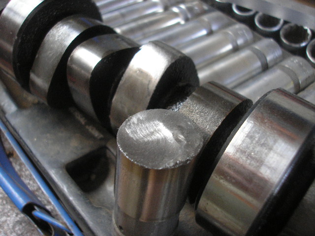

Well, I removed the oil pan, to find out that perhaps I had not put enough sealer in the rubber seal to cork pan gasket joint and it was weeping hot oil. I also found metal fragments in the very bottom of the oil pan. After a careful inspection and cleaning, I re-fitted the oil pan with a new gasket and a better layer of sealer and a stud kit I'd had laying around. All appears well ( or so I thought).
I had planned to re-do the lifter preloads while the engine was out, as it is much easier to do now. However, when I pulled the LH valve cover, I discovered the previously loose rocker was loose again. Tonight, after work I picked up an extendable magnet to pull the follower out through the cylinder head gap and inspect it. Well, nothing would move that lifter. Now realizing that the worst had happened, I pulled the intake manifold and bathtub and attempted to remove the lifter. Nothing happening. It would move up about 1/4", then it was stuck. It took a pair of visegrips to remove it. After that, it was disassembly and removal of the camshaft.
This is what I'd found. It looks as if during the cam run-in cycle, when the engine got a little too warm, the lifter got stuck momentarily and that was all it took to destroy the lifter and the lobe. That's close to 80 thou missing off the lifter base. I used one of the other lifters to check the bore. It had some small scratches from the old follower, so I massaged them out carefully and now its the same as the others. I've thoroughly cleaned the bore and oil gallery and now looking for a replacement cam and lifters.
I can't catch a break. :? :roll:

Aren't motors fun? Its alway something, even new stuff now days. How did it do on its test run besides the AOD?
Re: Rod's 84 BabyBajaF100
hobbyturnedobsession wrote: ↑
Mon Jan 30, 2023 12:06 pm
Aren't motors fun? Its always something, even new stuff now days. How did it do on its test run besides the AOD?
Hi Randy.
I like building engines, so it was disappointing for a lifter failure to happen for the first time in almost 50 years. Turns out it was a faulty cam follower. A local engine builder looked at the cam and follower for me and did a hardness test. He thinks the follower wasn't hardened correctly during manufacture. One in a few hundred million, I guess, and I got it. The new Comp Cam's cam has been run-in, but I was sent up to the mine on an emergency rescue mission to finish the bucket repairs, so I'll have to wait until I get home for a test drive. The new cam is lumpier at idle than I'd like, but appears to be very responsive (when that useless Edelbrock carb plays ball. It's getting a new Holley 1850 600 vac to replace it.) Looking for 4.10's to fit if I keep the auto, otherwise, I'm swapping both diffs to 3.7 for the manual and fitting 35's.
