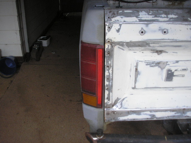

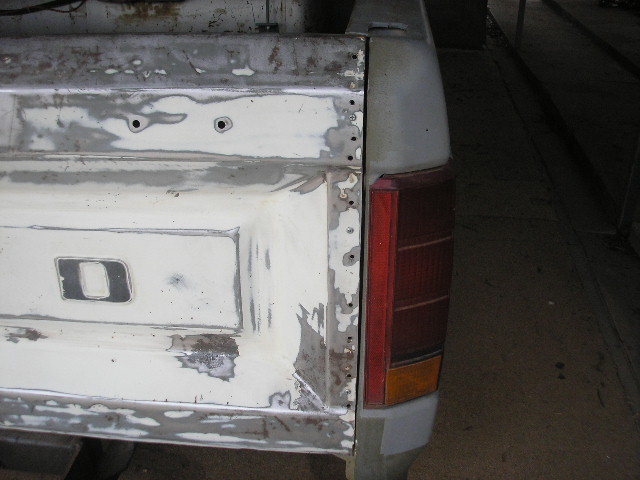

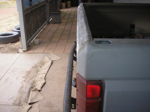

The side clearances are good, however the left upper and right lower edges will need some attention fron the flap disc to straighten them up and improve the gaps:
I had to adjust the RH body pivot slightly down and out to align the tailgate and body lines up perfect, and put some self drilling screws through to hold the alignment of inner and outer for future refefrence. Now it fits pretty good:
I will cut/drill a few latch loop shims for the body catches, as the closing alignment is still off slightly, but that's not an immediate issue. I plan to get another bucket full of used garnet tomorrow and will blast as much of the inner and outer needs to be done until it IS done or I run out of garnet again. Then the inners will be primed with Super-Etch primer and the outer sides lightly primed so I can start the assembly prep and filler work. Once the inners are painted and the assembly is final welded back together, then I will fill and prime the outside and prep the tub, tailgate and hood for paint after Japan. Then, it's all out to get it ready for rego mid/late December for Xmas.

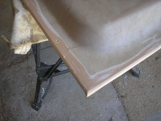

I was on the verge of throwing this side trim away, but now it's been scraped clean and sanded, it looks really good:
Ready for paint:
I'd got a almost new tan armrest from ebay, which I fitted before paint, painted it all carefully and fitted it once dry. I'll take pics tomorrow, as it has been raining all day here today and is about 14C (for a change). It's really wierd now, getting in and having door trims! :lol:

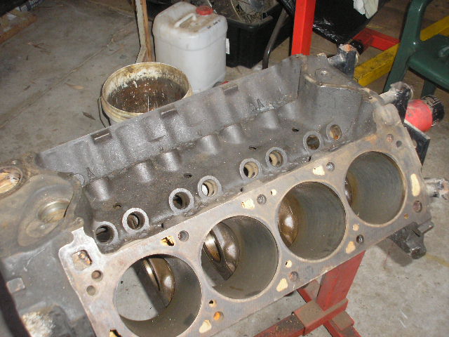

So, I’m finally building my own engine for the F100. Enough of other people’s engines, it’s time for one that won’t be coming out (hopefully) anytime soon. This 351 Cleveland short engine came out of an ex employer’s Falcon Utility (our version of the Ranchero) and was removed because of varying factors, partly stripped and then left exposed to the weather just inside the door of the go-kart track’s fuel store. 4 years later, I was offered it for free, to which I accepted. It was disassembled at home about 12 years ago and then stored on various shelves, forgotten.
Recently, I dragged it out and once on a spare engine stand, I flexi-honed the cylinders to see how bad they were. Except for some slight rust damage in 2 of them, I could have fitted new std pistons and called it done. Herein lies the twist to this tale.
First, a little history about Cleveland engines. I’ve built several of these, from basic re-rings to all out racing engines. I’ve heard all the stories, read all the opinions and I’m going to impart my experiences with these now forgotten marvels of Ford’s heritage. The 351C was developed for 2 reasons:
1/ To build an intermediate engine to phase out the old and getting obsolete FE engines and to fit in between the 289/302 Windsor engines and the 385 series big block 429/460 engines.
2/ To develop an all new power plant to fit into NASCAR’s new engine rules that were coming in the near future.
In the late ‘60’s and early ‘70’s, NASCARs were powered by large heavy 7-ish litre engines, running at 7000 rpm and making around 600 HP using a 0.600” lift camshaft. In 1970, a new engine hit the track. 200 lbs lighter, this 5.8 litre engine could make the requisite 600 HP, using the same 0.600” lift cam profiles at 7000 rpm and use less fuel doing it. That equated to 4 – 8 extra laps per tankful and the 200 lbs off the front end and re-distributed more advantageously around the car also meant 5 – 8 more laps on that stressed right front tyre (depending of driver style and car set-up). Imagine doing a Daytona 500 and having one less pitstop.
Anyway, a few problems were encountered along the way. Apparently, these engine did not have the desired ‘priority mains oiling’ that engine builders favoured. This meant that under certain circumstances, oiling problems and bearing failures became headaches. Unfortunately, the way the engine was designed and cast, the oil supply from the pump could not go directly to the oil gallery that fed the main bearings. This meant the oil had to travel the lifter gallery front to back down one side, turn around and then feed the other side lifter gallery and main feed galleries last. Anyone who has a good look at one of these blocks stripped down will see what I mean.
Another issue which was discovered by engine builders here in arse-tralia was that when they were limited to using the stock oil pan because of ‘rules’, it was EXTREMELY difficult to get them to last a race. I’ll explain.
One of the engine’s Achilies Heels is that the stock oil pump can actually empty the factory 4 quart oil pan of oil above 4000 rpm. This is due to the drain back passages in the cylinder heads being far too small for the job, resulting that the cylinder head rocker boxes kept a LOT of oil up there away from the oil pan where it was desperately needed. One ‘cure’ for this was to weld in tubes to each corner of the rocker covers and plumb 1” hoses back directly to the oil pan to help get the oil back where it was most needed. When the rules finally allowed dry sump systems, a separate stage was plumbed into the backs of each cylinder head to remove as much oil forcefully as possible. That and the dry sump system cured the external factors surrounding oil starvation to the main bearings. Other cures have been restricting oil flow to the top end by using gallery restrictor plugs, restricted feed pushrods, solid pushrods and oil spray bars, etc. to try and control the oil build-up in the rocker boxes. However, another problem reared it’s ugly head. It turned out that all these tricks and fixes started causing valve springs to fail much faster than normal, sometimes barely lasting a race. You see, oil isn’t just a lubricating medium, it is a COOLANT as well. A certain amount of oil splash was needed to keep the valve springs cool, otherwise, due to their flexing as the valves are opened and shut at fantastic speed, they get VERY hot. Heat destroys the spring’s temper and it weakens quickly. Until dry sump systems were allowed, it was a very delicate balancing of oil flow vs oil pan capacity and managing drain back to keep the engine alive.
So, lessons I’ve learned, regardless of what the engine is for:
1/ Use a larger capacity oil pan and a good windage tray (minimum of 7 litres/7 – 8 quarts of oil). A good windage tray is worth 8 – 15 HP, plus it helps remove unwanted oil and mist blanketing the rotating assembly that could be in the oil pan doing it’s intended job.
2/ For stock or MILD street, a STD capacity oil pump (Melling) is fine. No need to have any more oil flying around in there than is needed.
3/ If road racing and class and budget allow, DRY SUMP it. Unless you can get enough capacity in a wet sump and control oil movement, you WILL have issues. Personally, I’ve NEVER dry sumped any of my engines, I’ve built my own oil pans and am proud to say I’ve never lost an engine to oil surge or starvation.
4/ IF you really MUST use restrictors, only use them if you are using a SOLID ROLLER camshaft and plan to turn more than 7500 rpm.
5/ My advice is DO NOT put the restrictors in the cam bearing feed galleries. A standard engine only has 90 lb on the seat and around 200 – 220 lb on the nose. Performance camshafts require stiffer springs and in the wilder grinds and rollers, 200+ lb on the seat and 450 – 500+ lb on the nose is not unusual. This puts a lot more pressure on the limited oil pressure/volume to keep the journals from touching the bearings and limiting oil flow and volume here can be catastrophic. I personally do not use restrictors in my engines for various reasons, but especially not in racing engines.
The 351C I am building started with a 1980 ‘GF’ cast (Geelong Foundry, Victoria) 2 bolt main, small distributor pilot block from a car an old employer had, a 1995 Ford Falcon utility, backed by a Borg Warner single rail 4 speed manual and 2.75:1 LS 9” disc brake diff. After tearing open the oil pan (it was too low at the front) several times and loosing a lot of oil, it was removed for a replacement backed by an FMX auto trans. This engine sat for many years prior to this build. I went over it thoroughly with a die grinder inside and out, cleaning away loose casting slag and de-burring all the edges, smoothing all the oil passages and drain back areas. I also used a 5” grinder on the outside, removing all the casting flash and smoothing every edge to make it look and feel less dangerous to my fingers and knuckles. I had to weld large nuts to the factory coolant drain plugs to get them out, but out they came. The valley was carefully drilled and tapped for the 5.0L HO hydraulic roller spider for future use. (I have plans). Every threaded hole got a new tap run through them and then it went off for machining. The bores went out 0.030” over size, the decks were squared and surfaced a minimum, and it was chemically cleaned. New camshaft bearings also went in. When it came back, all the oil galleries were brushed out with solvent and a 20ga bristle brush, all the lifter bores were cleaned and tested with a new lifter for burrs and fit, new oil gallery plugs, freeze plugs and rear cam plug were installed with non-hardening aviation sealer and it was washed and wrapped up ready for assembly. The Australian cast crankshaft required grinding the crank pins to 0.010” under size and the mains 0.030”. This was due to wear on the crank pins from being driven with a lack of oil (due to the damaged oil pan leaking) and corrosion damage at the oil hole on #5 main journal, caused by water seeping in down the oil sender hole and settling into the bearing gap during storage in the weather. It was cleaned and fitted to the block on King bearings with a Fel Pro neoprene oil seal and plasti-gauged out at 0.003” clearance on all journals. A little of the loose side, but I’m happy with the clearances. The Speed Pro H555P hyperutectic 0.030” over size flat top pistons had their ring gaps checked in their respective bores and averaged out at 0.015” for the top ring and 0.012” for the second ring, these were fitted to their pistons and installed, with 0.002” bearing clearances on the King bearings. The factory rods have been closed and resized back to correct and fitted with ARP Wave-Loc bolts.
A Melling HV oil pump was clearance checked, primed and fitted with a Milodon pick-up and HD drive shaft and was bolted down. A mixture of ARP and Milodon main studs are fitted, the Milodon studs are extended to use their rear pan windage tray, which was manouvered into place, clearanced to the rotating assembly and tightened to spec. As I cannot buy the correct Milodon oil pan (or the Canton equivalent) for love or money, I am building my own version, holding 7.5L (8 quarts) to fit the F100. That should be finished next week. Should I happen to find one of these elusive oil pans for sale, I’ll hit the ‘buy it now’ button and keep mine for a later project. The camshaft is the Melling version of the Elgin 953P (204/214 @ 0.050”, 0.494” IN/0.512” EX) installed with moly assembly lube liberally applied to the lobes and set at 4.5 degrees advanced. This is the same cam we fitted to the old 351C I removed at Xmas. Driving that is a premium billet Rollmaster timing chain set with a Torrington bearing cam thrust plate and bearing upper sprocket, Iwis chain and hardened multi-position sprocket on the crank. I have refitted the factory fuel pump eccentric, on the odd chance later on I will use the mechanical pump. The bead blasted front cover was fitted with a new seal and bolted on.
I have a new Powerbond street strip harmonic balancer ready to go on with a ARP bolt and washer, a Milodon HV water pump with ARP fasteners and I am currently debating over what cylinder heads I will put on (depending on available funds).
That’s my progress so far. Pictures and more to follow.

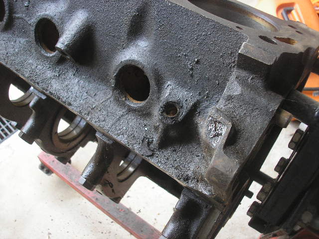

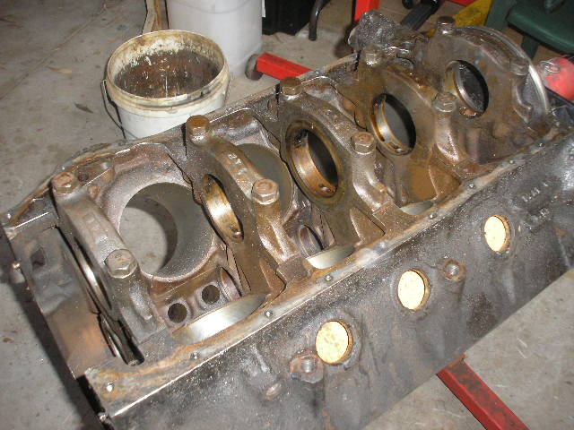

Donor 1
Donor 2
Water jacket drain plug removed.
Donor 3
After welding the nut to the broken drain plug.

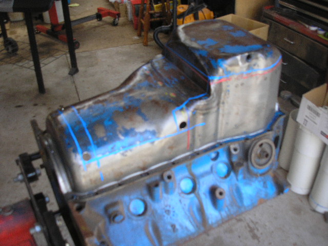

Marking out the old 'modified to fit another vehicle' oil pan from the 400M for cutting:
First cuts and test fit:
Fitting the first part of the new oil pan section:
Yes, I bolt the pan fully to the block during this stage to make sure I don't get any wrong measurements. This is the 400M block.

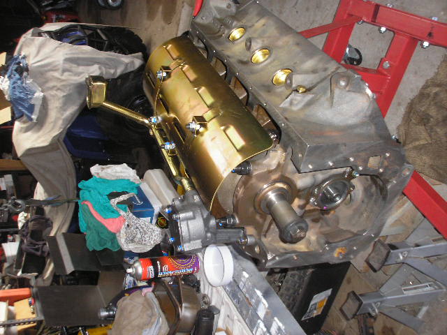

And, in my usual fashion, I forgot to take pictures during the short engine assembly, but I managed a few AFTER I bolted on the windage tray and set it's clearances:
Pic 1
Pic 2
I have installed the timing chain set since this was taken and the cover is now on.
I'll try and take more as the oil pan build progresses. I'm waiting for the balance installer kit to arrive and the ARP water pump fastener kit. I will TRY and provide more pics as the engine assembly goes ahead, too.
