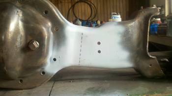

Alright, pulled out and cleaned up some beams, theres a flat spot on the bottom of the ds beam, i marked a dotted line threw where the cut would be, its at 90 degrees to the flat spot....am i thinking correctly here? My plan is to make a jig to keep things inline just doing a little research now...
Re: 95 f150 4x4
My opinion is a little farther to the right, you want equal meat to weld the extension to and equal meat to stick the outer wrap plates to. It's not wrong what your proposing its just the way I would do it.

Rmc wrote:My opinion is a little farther to the right, you want equal meat to weld the extension to and equal meat to stick the outer wrap plates to. It's not wrong what your proposing its just the way I would do it.
Makes sense

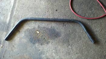

Went and bended some more pipe up for the front bumper for the piece that goes over the top of the lights, took a little detour back home and i forgot how good those ttbs soaked up the bumps vs the straight axle. Even with the stock supension and 35s there was a huge difference, a lot faster and smoother for sure, but a 351 is definitely in the works, going to ha e some serious fun with this build, i hope i can keep it out of the trees....you guys out there might not have that kind of problem....

Little more bending
