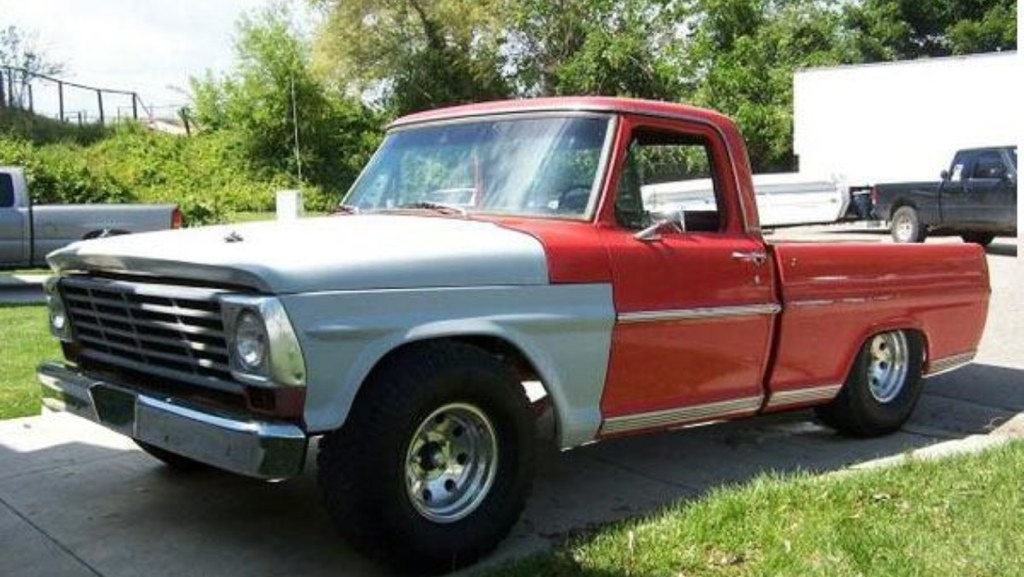

I also photoshopped a similar truck to my desired ride height.

Replace hood with grill in above post.

Didn't realize that's what you were going for ride height wise. You going for a short course style, 75% droop type suspension on it?
Re: Yup another Philofab Project... 1971 Ford F100
Yup. I mostly want something that gets attention on the street and can be useable...
That is why it will have a bench seat, a complete bed, and get good gas mileage.

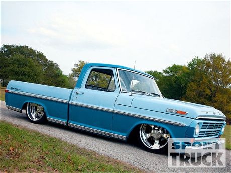

I think this is what he's going for...

Orange truck is MUCH better looking than the blue one. Never got the dragging on the ground thing with a truck. Only trucks I can understand lowering are the 1940's and earlier.
The Blue one is nice, but impractical for everyday driving. I've had tons of lowered trucks over the years and one like that is nice for the weekend but gets tiresome driving every day.ChaseTruck754 wrote:Orange truck is MUCH better looking than the blue one. Never got the dragging on the ground thing with a truck. Only trucks I can understand lowering are the 1940's and earlier.
I want something that can be driven like a stock truck and isn't so terribly loud inside I can't hear myself think.
