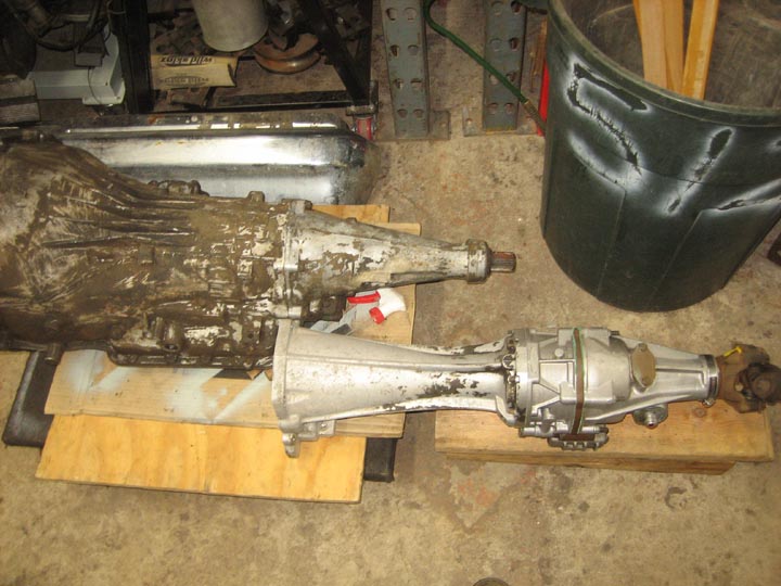

Already drawing up the plans for the solid body mounts I'm going to turn down to lower the thing a bit (TINY BIT), and then messing with the drive line plans (pics below ;) )
I have a culhane race c6 (not the trans in the pic) and I bought the gearvendors to go in the crew, but since I went manual trans on that - it's going in this.
I am trying to decide how to mount the gear vendors... Right now my c6 has the fixed tail shaft (1st pic) because it is shorter/stronger. I'm getting mixed opinions on how to mount it though. New thread started on this ---> http://www.gofastbroncos.com/forum/view ... 7822#p7822

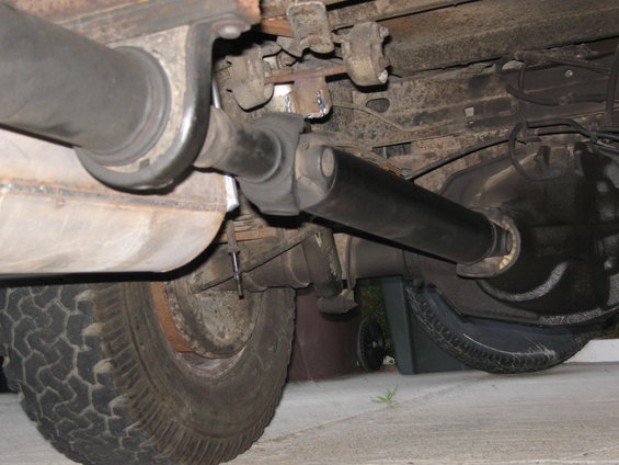

Hey Steve,
Can I ask how much you paid for your Gear Vendors unit as I have been thinking of doing away with it and buying a built up overdrive transmission to reduce the number of components in the driveline:
And is your Crew running a two piece driveshaft like mine is:
Re: A pair of 74's...
Got it for $700 or $800 a couple years ago. I found out after that a buddy used to grab them from the junk yard for $200 - $300 and re-sell them for $600 or so right about the time I bought mine. Oh well.
If you end up wanting to part with it - let me know. I've got a couple buddies who I think are looking for them.
And on a side note - DAMN that is a long drive line assembly with the GV and the carrier bearing, etc in there!
I am trying to use the GV in place of the carrier bearing since the carrier bearings always seem to cause issues.
