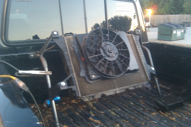

took out core support, and relocating radiator to rear with electric fan from 3.8 taurus.

BTW, the radiator set-up like that will not work well...........

Bed-mounted radiator... that takes me back. Mine worked OK but I had a larger radiator, dual fans and I put a scoop under the truck.
Had I to do it over, I wouldn't.

The airflow on that thing at speed is probably not the greatest.... especially with a complete bed floor.
Out of curiosity, what made you move it there?

moved it for several reasons, mainly practice for my other truck. also the core support was totally rusted out along the bottom 1", and a new one was $200 and i didn't spend not half that doing it this way instead. finally i think it looks cool, and thats about the only reason i need.
as far as not working well, if it doesn't (just like everything else i have completly built and designed by myself without another truck like it within 1000 miles of me) i will figure out a better way to do it.

as far as cooling goes, it seems like it was working pretty well. however, i definetly need dual fan with a shroud because it would slowly start creeping up, and i wasn't doing anything too hard with it. and then, like a dummy, i put the 5.0 (that i am going to build as a race engine for my 2000 f150), into the bed, and it rolled, barely bumping into the radiator. it didn't damage the actual radiator, but the plastic mounting tabs cracked slightly, letting a small amount of coolant start to leak. so it will be out of commision for a few weeks until i buy a new radiator. let you guys know more then.
