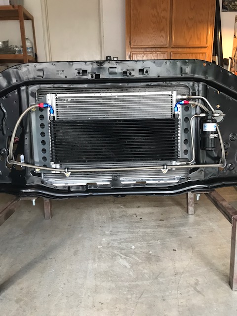

Looks like several folks are putting Vintage Air into their trucks. I started this process awhile back and have been working on it slowly.
I started with a straight core support from the local yard and first mounted a new Champion radiator on it. then came the AC condenser with a big Super Duty Trans cooler in front of that. Ryan at the Fab made up a sweet bushing for lines going through the firewall and some lower mount bushings on his 3D printer.
