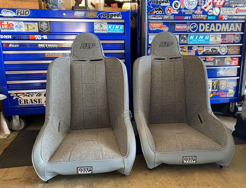

new seats finally showed up yesterday, really stoked at the color match to the factory ford gray and the cushion is really nice too. If youre in the market for seats give these guys a call, this is Hunter Safety Products which is the Beard family, they just cant use the name anymore because they sold it to whoever bought Beard.

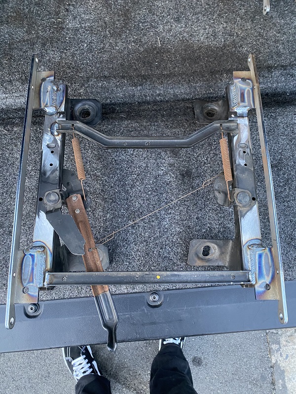

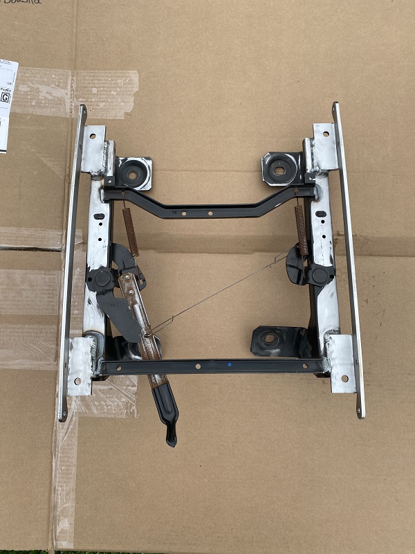

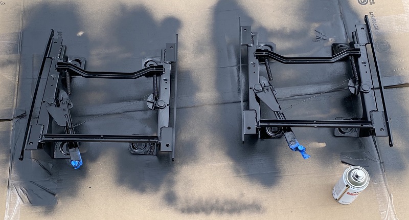

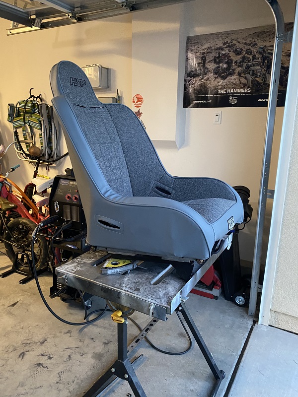

I ended up purchasing the solo seat mounting kit to adapt the seats to my stock sliders, one thing that was a concern was head clearance especially once I cage the truck (I'm 6'5), so Andy was nice enough to help me cut down the upper slider and weld on the mounts, which should buy me 2-3" of head clearance. Cleaned up the sliders and hit them with a couple coats of spray paint. They look ok other than the front mount part which seemed to have run because of the angle. Tried cleaning it up and repainted it a few times and it got a little better but ultimately just decided to say screw it and send it.

These are done now (and look good), for for those other tall guys out there, you should be able to flip the mounts upside down so the bolt holes on the brackets like these from Solo point down vs. up. As long as the bottom of the seat is still up 2" or more from the cross members on the sliders you should be good

ChaseTruck754 wrote:These are done now (and look good), for for those other tall guys out there, you should be able to flip the mounts upside down so the bolt holes on the brackets like these from Solo point down vs. up. As long as the bottom of the seat is still up 2" or more from the cross members on the sliders you should be good
Tried that the first time around. The bottom of the seat would get eaten up on the slider when moved forward and back.
Re: 1995 F-150 Build
Got it. I've always made my own and flipped them down often. I haven't used the solo ones before so they must be a bit different dimensionally
