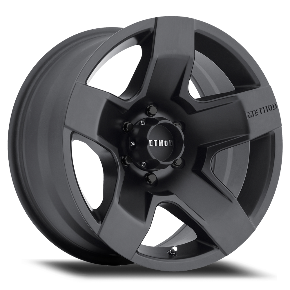

For now, adaptors for the D44 TTB to run 8 lug wheels (Method 17" x 8.5/9" w/ 35's).

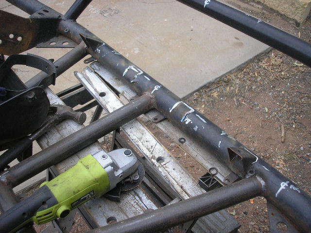

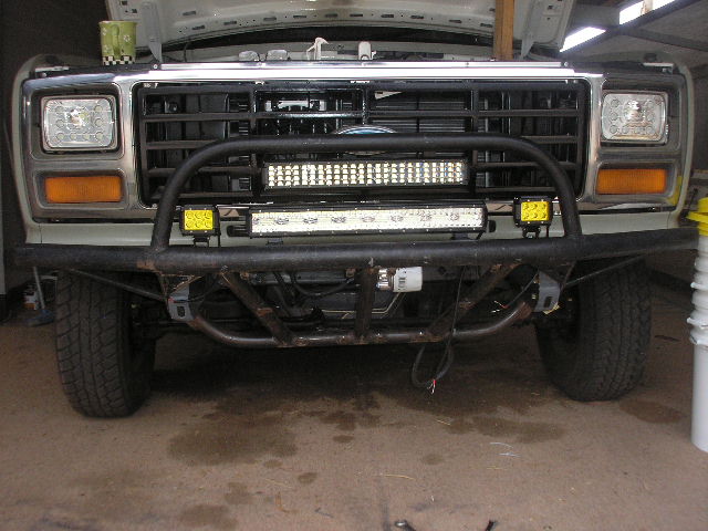

Been playing with light options for the front bar. originally, I had the 4 Narva lights, 2 spots and 2 spreads and was going to use HID's, only to find the housing is j-u-s-t too shallow to allow the bulbs to fit. Bummer :x I'm not interested in dumping more money into new spot lights, so I decided to try the new LED bulbs, to see if they were as good as all the wankers are saying. Disappointing. The light is nice, but hasn't got the range and illumination the halogens have. So, I did some research and bit the bullet on a pair of LED light bars, a 23" combo flood/spot and a 20" spot. I had a pair of amber LED lights I picked up in China last year and sat down today to work out how they'd fit. The ambers hung down too far to go outside the main area, like the old ambers I had, so after much deliberation, I pulled the bar, did some measuring and marking and cut off all the light brackets previously installed for the Narva's and fog lights:
The new light bars:

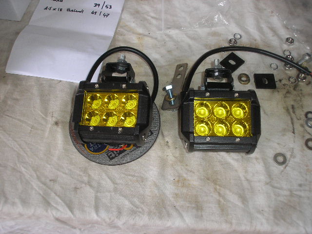

Ambers:
I admit I felt bad cutting off the mounts, as it meant I'd have to re-do them again if I decided to go back to the Narva's, but I needed to re-position the mounts to get the effect I wanted. Cutting, grinding, sanding, welding and a little black exhaust paint later, and after a quick fit up, the result:
The upper spot bar has the mounts on the upper hoop, so I could keep everything inside the hoop where it was less likely to be damaged in the brush or from a marsupial strike. When I get home Friday, I will start wiring them up and finish off the tabbing on the bumper for the top trim plate (aly chequer plate) and a HDPE strip around the front, so I can get it blasted and painted. Then I can finsh the rear bar, paint the tub and make it look like it should. I also have to pick up a 4mm piece of alloy sheet to make a skid plate for the front.

One week ago, it has been 7 YEARS since I first took the truck apart (April 14). I went out, sat in it and warmed up the engine, just to listen to that beautiful idle it has, closed my eyes and thought about how long it's been...... and where I want to take the build. I'm happy with the 3/4 ton running gear upgrade, and building my own engine for it, but I might keep the auto for a little longer. Once it has had the valve body upgrade and I finish setting the TV cable right, I'll see how I like driving it and decide from there. The carpet and underlay are here, the front lug adaptors are on their way and I'm trying to find the correct vinyl paint for the door trims. I haven't had the time off to co-ordinate picking up the rear axle yet, but I will try after Easter. I've found a rear disc set-up with e-brake calipers and will order them once I have the axle in my possession. I have my contacts looking for a complete D50 TTB plus the frame section and a 435 set-up, in case I change my mind on the auto. We have Anzac Day this week coming, and I will be away from Friday to mid next week in Sydney with the Handbrake, so I am planning for painting the tub outside that weekend. I've also selected the Methods I want:
17" x 8.5", 4.5" backspace.
I'll mount Achilies Desert Hawk M/T's in 35/12.5R17 on them and see how I like them. I've sent off emails for fiberglass to several of the popular suppliers to see what deal I can get (including shipping to Aus). Otherwise, I have a plan.
