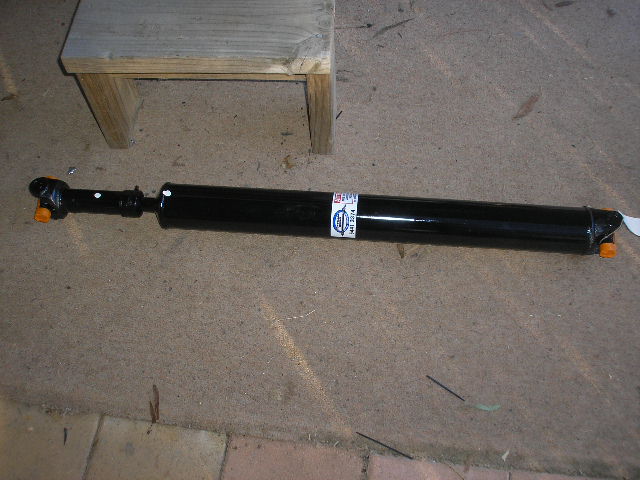

The driveshaft guy swapped the front uni in my driveshaft for the correct one tonight after work while I waited, so that's ready for duty, and I pick up my 2 1/4" mandrels tomorrow, so I can make a start on the Y pipe.
Some pics:

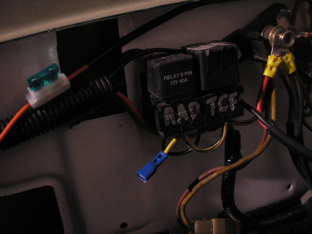

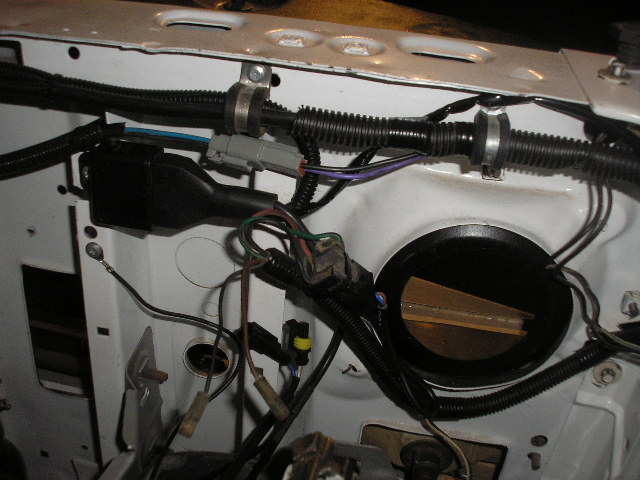

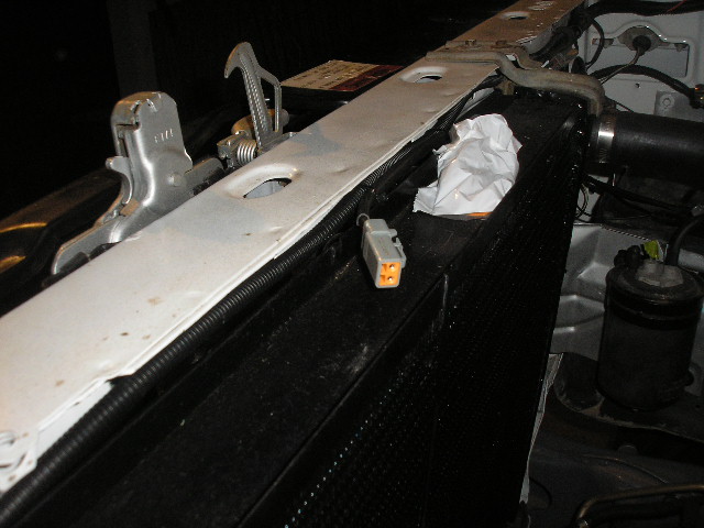

Driveshaft: Radiator and trans cooler wiring: Choke mechanism on: BajaHID at work: P clips holding the heater hoses: I'll take more as it progresses.

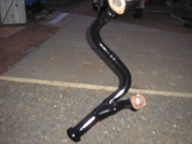

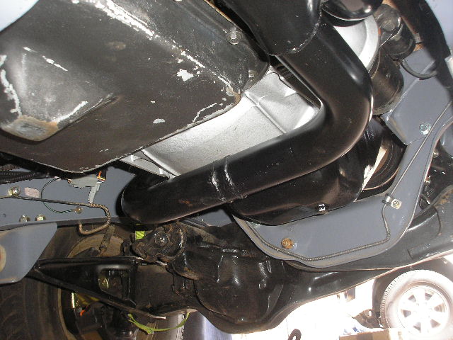

Well, I didn't do any work inside the cab, instead I did some re-wiring in the carport to re-position some lights. I have 2 flouro tube lights that are dead, so one of them got the flick and I re-positioned another that still works to throw light better on the back of the truck. Previously, it was above the cab and wasn't much use. Now that the days are shorter and light is disappearing fast in the afternoons, I need to get the lights up to scratch so I can work longer.

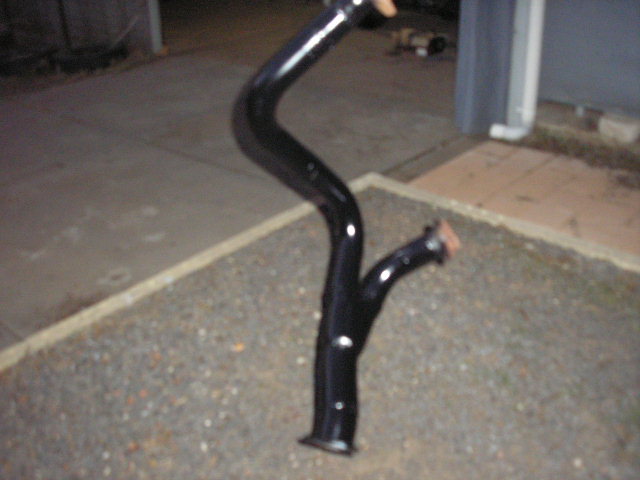

After I did that, I got started on the Y pipe. I trimmed some excess of the 45 deg bend and added it as filler for the 90's. The picture is lousy, due to it getting dark, the camera always does this is poor light: I also installed a 25 amp Deutsch plug on the radiator fans loom end, ready to make the connector harness to the fans after install: I'll start on the inside tomorrow, when the light is better, after I install the Y pipe and test run it.

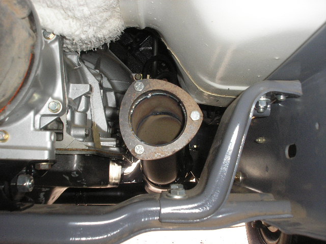

Sunday April 16th:
Y pipe fitted. It has a slight leak at the flange bell, but I will fix that later: I have other pics, just need to resize them a bit. Later.

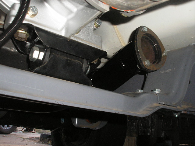

More (re-sized) Y pipe pics:
I'll keep the updates coming.
Cheers.

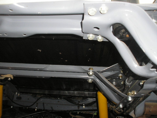

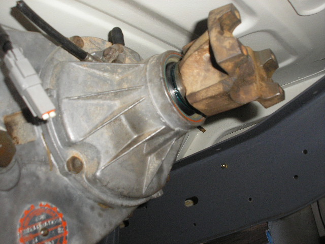

Turned the chassis bolts up the other way so they don't interfere with the side tank re-install:
New t/case seal:

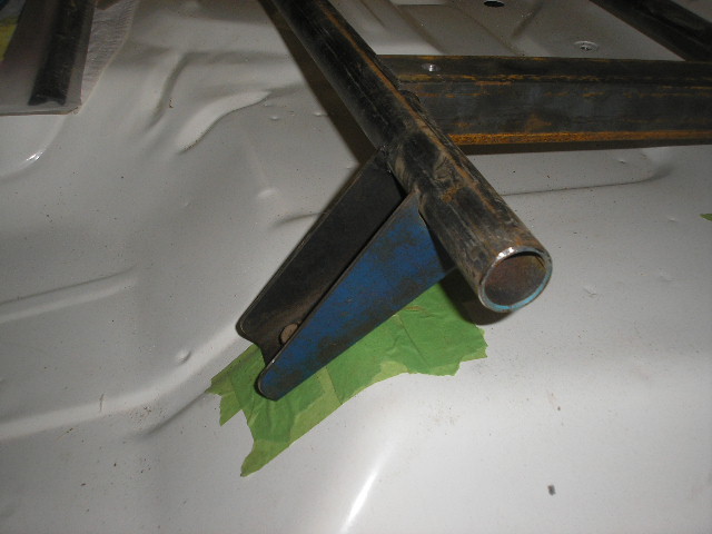

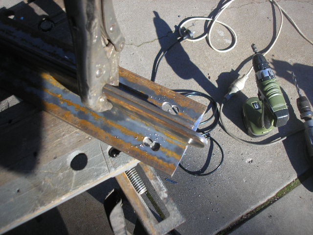

Wednesday April 26th:

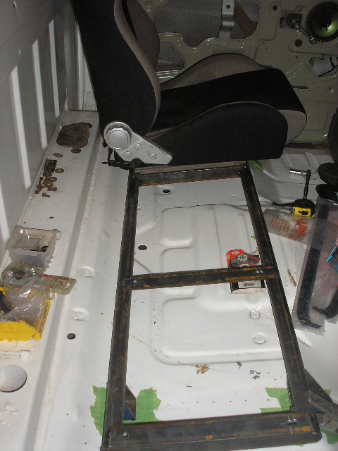

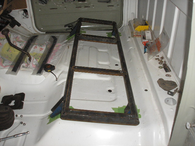

I made my seat cradle. I had it all tacked up yesterday, but ran out of mig gas before I could weld it up proper. So, I took it into work today and welded it up during my break. It's now fitted in the truck with the driver seat mounted, I"ll have to do the rest when I get back as I have no time now other than pack it away.
Mounting brackets: tubing sitting in place: Driver's runners tacked in, passenger runners being tacked: Prior. Screwed up the hole centre measurment for the tracks, redrilled: tacked up, ready to take out and weld up: If I have time tomorrow, I'll snap the seats in place, just have to fab a mounting plate for the centre console, weld it on and fab the shifter mount (once it arrives). Once the shifter is mounted, the cable installed and the electrics done, I can drive it.
I'll update in a week or two. Check out my trip report after Saturday, I will post up when I have internet access.
Cheers.

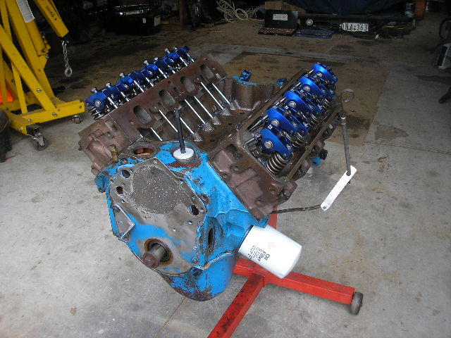

Well, I am 95% going for my 400M engine into the F100. I can use Mick's old Bronco engine rebuilt, but the extra 50 cubes, 50 - 75 extra HP and 100+ LBS- FT of torque are really pointing me in that direction. I've found out by carefully measuring the engine mounts, the 400M will fit the small block mounts, but will set the engine back 1/2 an inch (or forward 1/2 an inch depending on which mount goes where). Anyway, since I pulled the 351 out for Mick's Bronco, and I'm not comfortable using someone else's engine in my truck, I'm going to suck it up and rebuild my own. I'm having trouble finishing this post because I'm so f-ing tired, so I'll update further later this week.

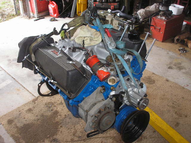

After getting the truck out of the garage where she has been for the last 5 months, I wheeled the engine to the doorway for a final clean and freezeplugs before taping it up for a coat of Ford Blue:

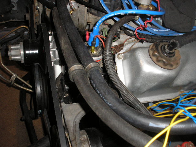

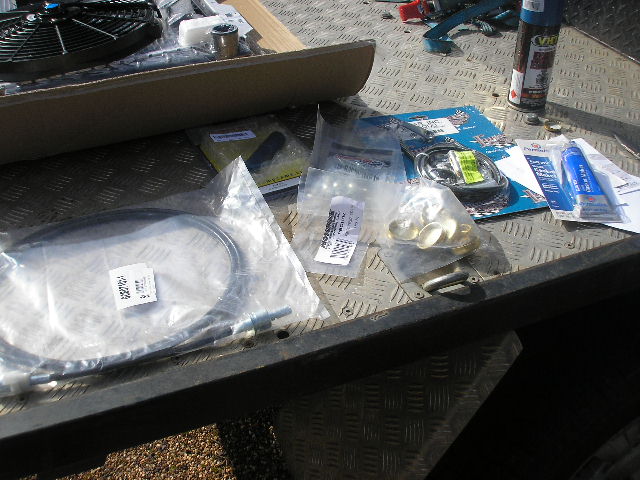

Some of the stuff I bought. The new power unit 1 The new power unit 2 I spent the afternoon fitting the water pump, alternator, etc and generally getting it ready for install. The rockers have all been adjusted, the intake will get washed tomorrow and installed, along with the distributor, and once I find the bloody seperator plate, I'll sling it up, fit the plate and flex plate and start the install. The plan is to fit this engine, run it in on gasoline and get the truck finished while I organise my own new engine. I'm saving for a Pavtek 393 stroker DIY kit, and getting my own block machined at the same time. This will have a Comp 270S solid lifter cam kit and topped with 2V AFD alloy heads and Edelbrock Air gap Performer.

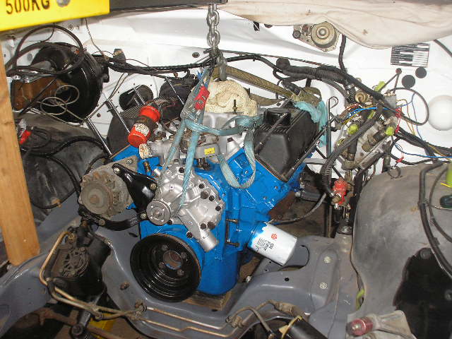

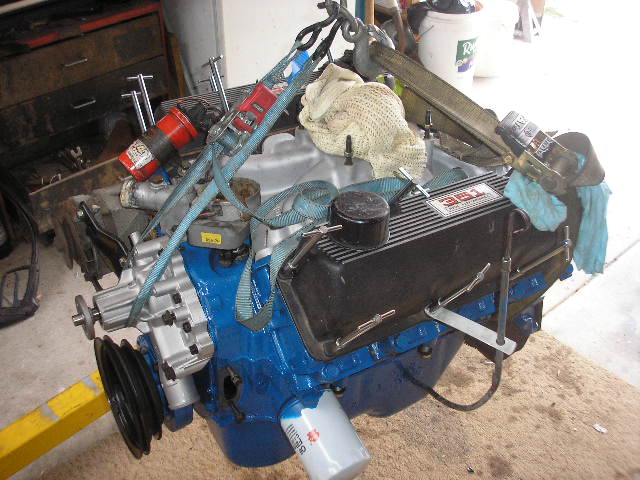

New heart, ready for install:
More soon.
Installed, waiting for it's Autofab race engine mounts:
Stuff waiting to be installed:
Starting to get excited, hopefully it will be running and I can drive it before going back to work.More soon.
