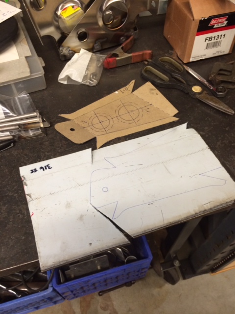

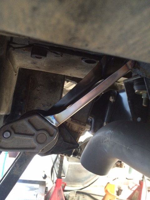

A little more stainless work and other small stuff over the last couple weeks or so.
Support brackets for the AMP steps - pass side.
Front
Rear
From this:
To this:
Front
Rear
From this:
To this:

It's amazing how muck time brackets like that stainless one can take. Trying to figure out the multiple, compound angles is tricky, and even with multiple stages of cardboard templates & many test fits (which include crawling under the truck and across to get to the pass side) there always seems to be one angle I didn't get right. It's finally done though. Just in time to start the driver side one... At least I can access that side much more easily & my crawling back & forth on my knees under the truck may be done for a bit.

Agreed, but they were not a must until the wife & kid came along. I like the look without steps, but the lady wants a step and with the height of the truck & kids it turned into a need. AMPs, while very expensive (even used) are a good step and worth it, so that is why the effort is going in. I thought about & looked at other ways of doing it to try & save the cash, but everything was a compromise. These are not really a compromise but the price shows it. They hang or get lower than other steps, but are then out of the way when out of use vs. hanging down low. I love that!
I do agree that the effort it is taking to make them fit a vehicle they weren't designed for will be worth it, although it is taking a way a bit of time from other, getting it running stuff on the truck
