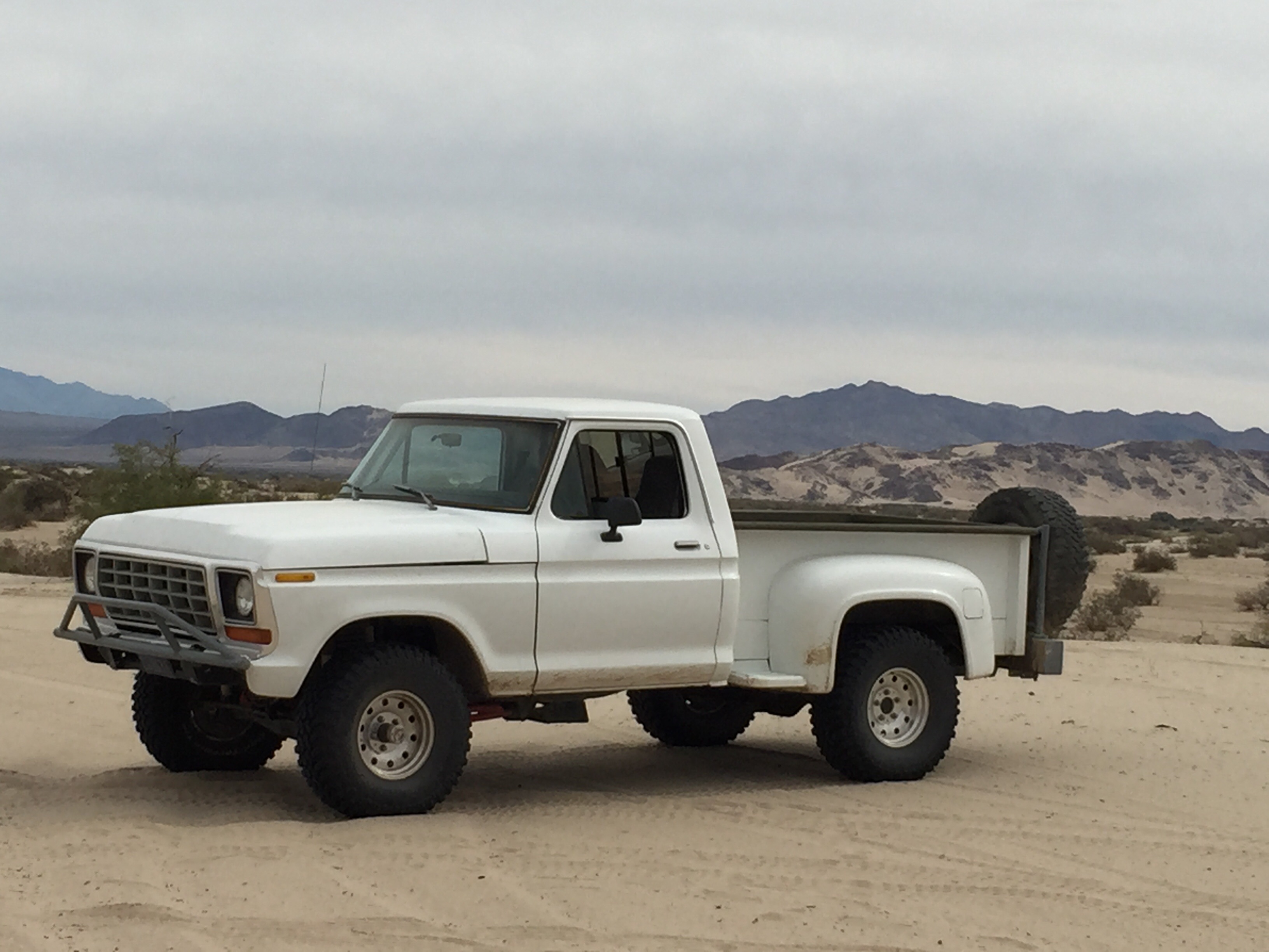

Hello, names Eric. Picked up this truck from my buddy couple weeks ago.
72 body on a 80's f150 frame. 351w stoked to 396 ( lightning cam and crank with gt40 heads), built aod to handle the extra power. Progressive coils up front and national leafs in the rear. 50/50 weight distribution as it sits.
Plans for it are to copy my brothers (turf tamer) front end and cage when money allows it.

Awesome truck & thanks for making a "build" thread on this! This truck is close to what I have wanted to do for a long time. You mind snapping any pics of how they did the body mounts? I figured with the frame differences between the 70's (that is a 73-79 cab by the way) and 90's the body would have to sit a lot higher than it looks like yours sits. I'd be interested to see how they did it!

No problem I'll get some later today.

Perfect! Thank you! That answers my questions as to the front cab mounts. I've seen a couple threads on other websites where guys have done similar, but no one ever seemed to take pics, and their cabs always sat so high on the frame for some reason
