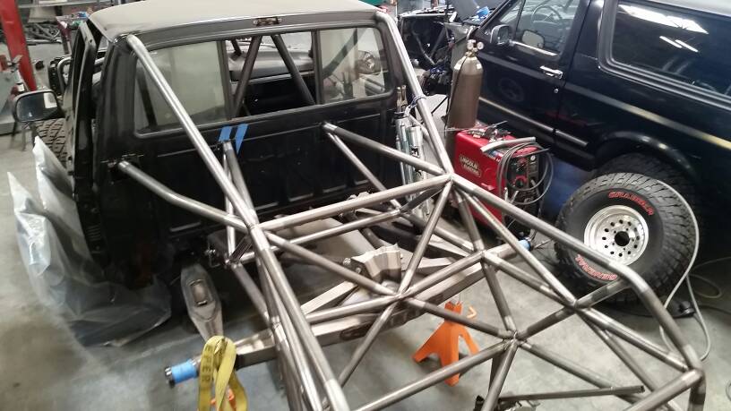

Thanks, finished the tubes for the fuel cell portion of the cage, and got it welded up

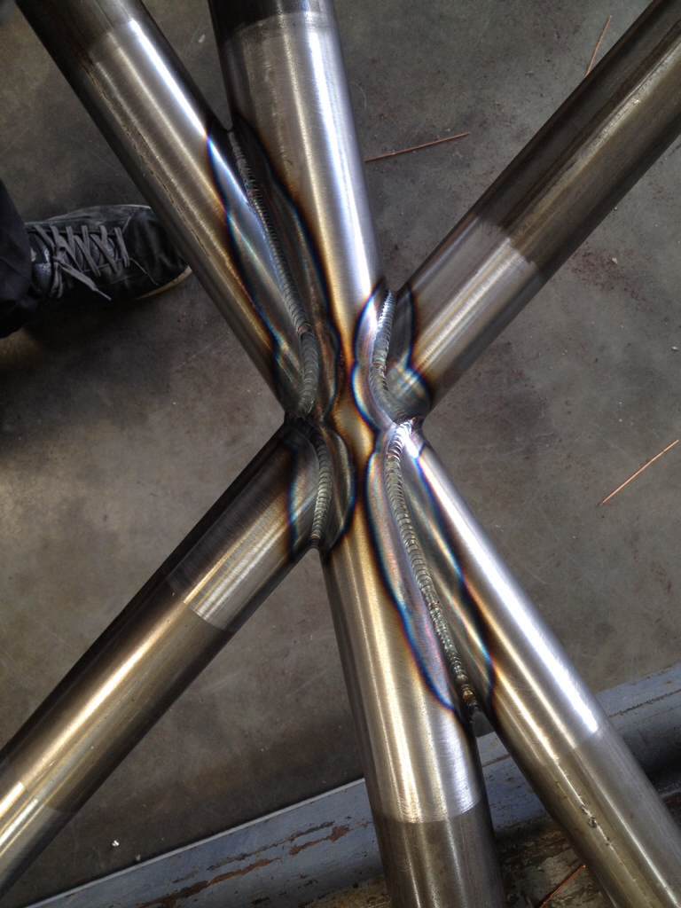

F@!k Me you can weld! It's so good it pisses me off... J/k :-)
Posts: 2338
Re: Black Lightning
What method are you using to clean the tubing prior welding? DA sander??
Re: Black Lightning
Looks like a scotchbrite wheel on a bench grinder

That welding and fitment belongs in an art museum! Wow!

Thanks, i put the tube in a vice and use a long 120 grit burr king belt. Ends up being a serious work out after a bunch of tubes! Wish we had a lathe
Re: Black Lightning
Oh!
just tell Johnny to get a scotch brite wheel for the grinder!

ChaseTruck754 wrote:Oh!
We just got another burr king, and some red scotch bright belts for it, makes life soo much easier
Re: Black Lightning
that works perfectly well too. Your forearms will thank you.

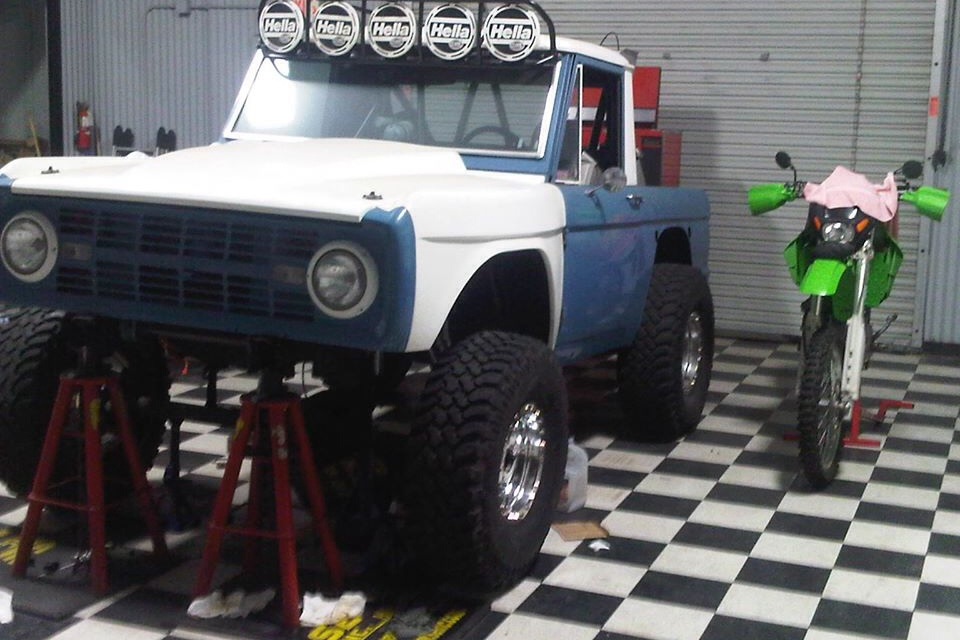

Early Bronco spotted, need more info!

ESHALLBETTER wrote:Early Bronco spotted, need more info!
That's my buddy Wayne's Bronco, I think it is a 67. Built a new engine cage with 3.0 bypasses and new coilovers, mounting a wider axle, new cbr radiator full tube core support etc... Here are a couple old pics

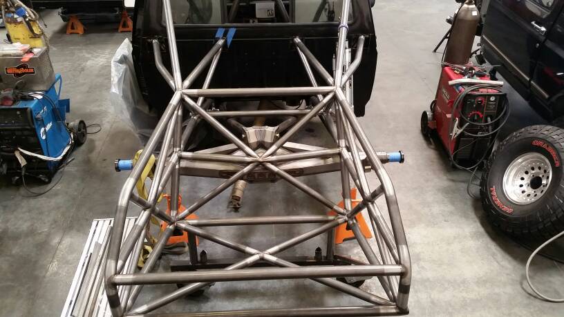

Back half is geting there, still have to box the frame rails back to the bumpstop, and do shock mts. The open tube near the bypass is for the sway bar
