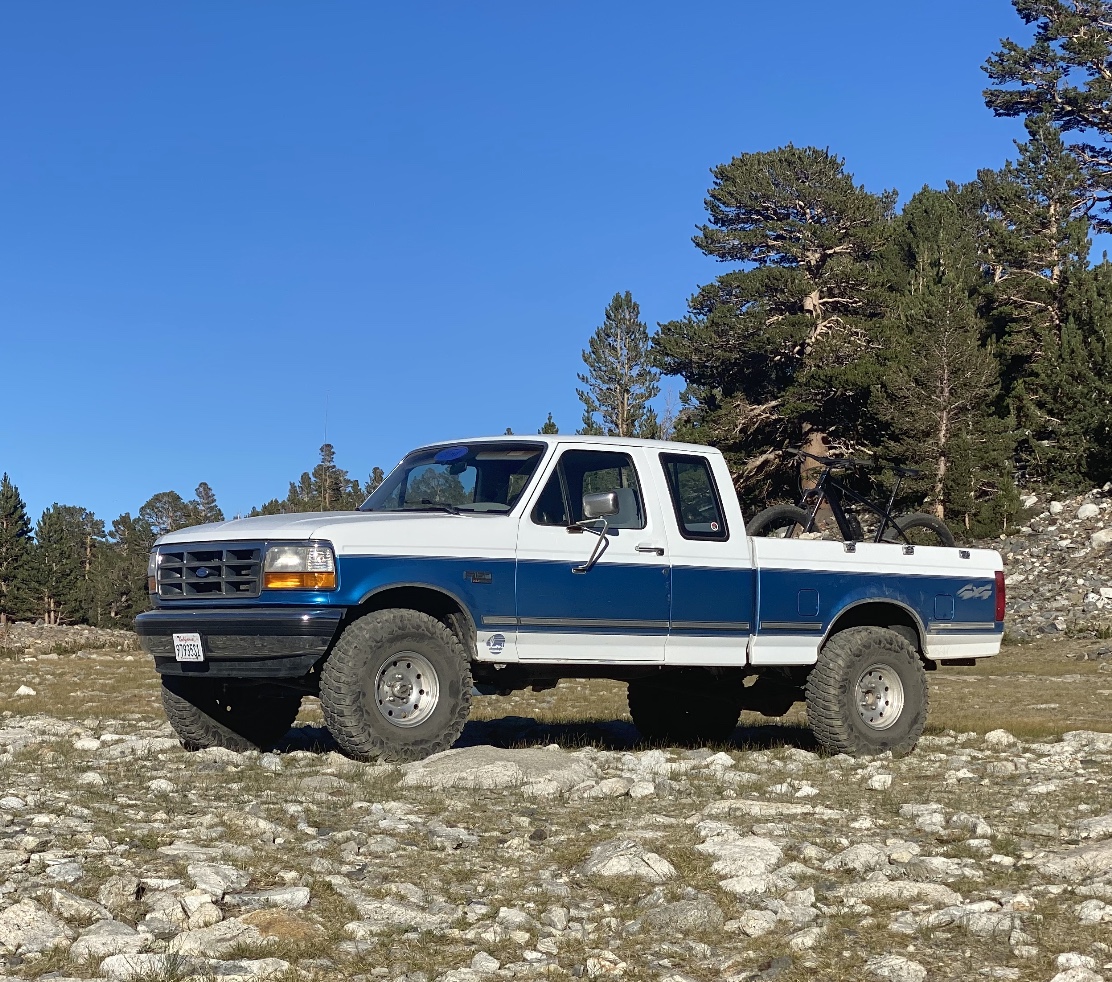

Re: Spring rate questions
Can anyone offer up some wisdom?
2.5x12 kings ordered from desolate, they supplied 400/450 springs. This is with 2.5” of preload, still seems too low to me but from my searching, my spring rate is spot on.
