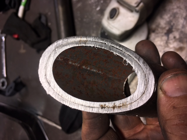

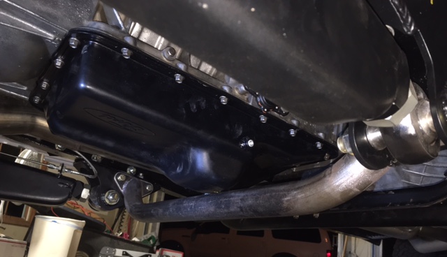

Here's what I came up with to tie the radius arms together -- kinda peer committee approved lol! 1 3/4" turned into sorta .250 wall via 2 pieces of .120 wall tubing because I'm cheap! Loses a pit of ground clearance but it's still 2" higher than the front differential- time will tell whether it gets ripped off all to hell.
