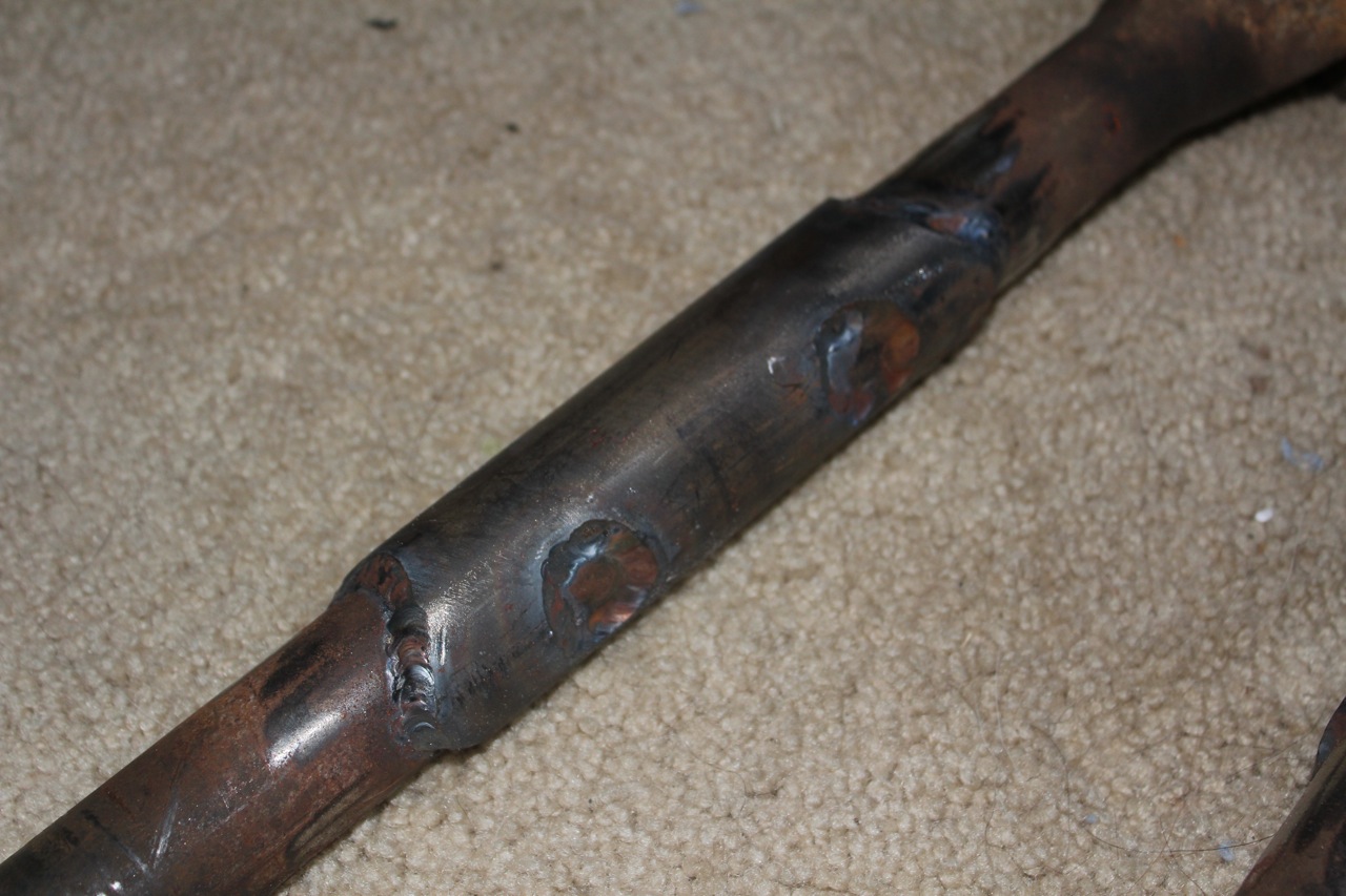

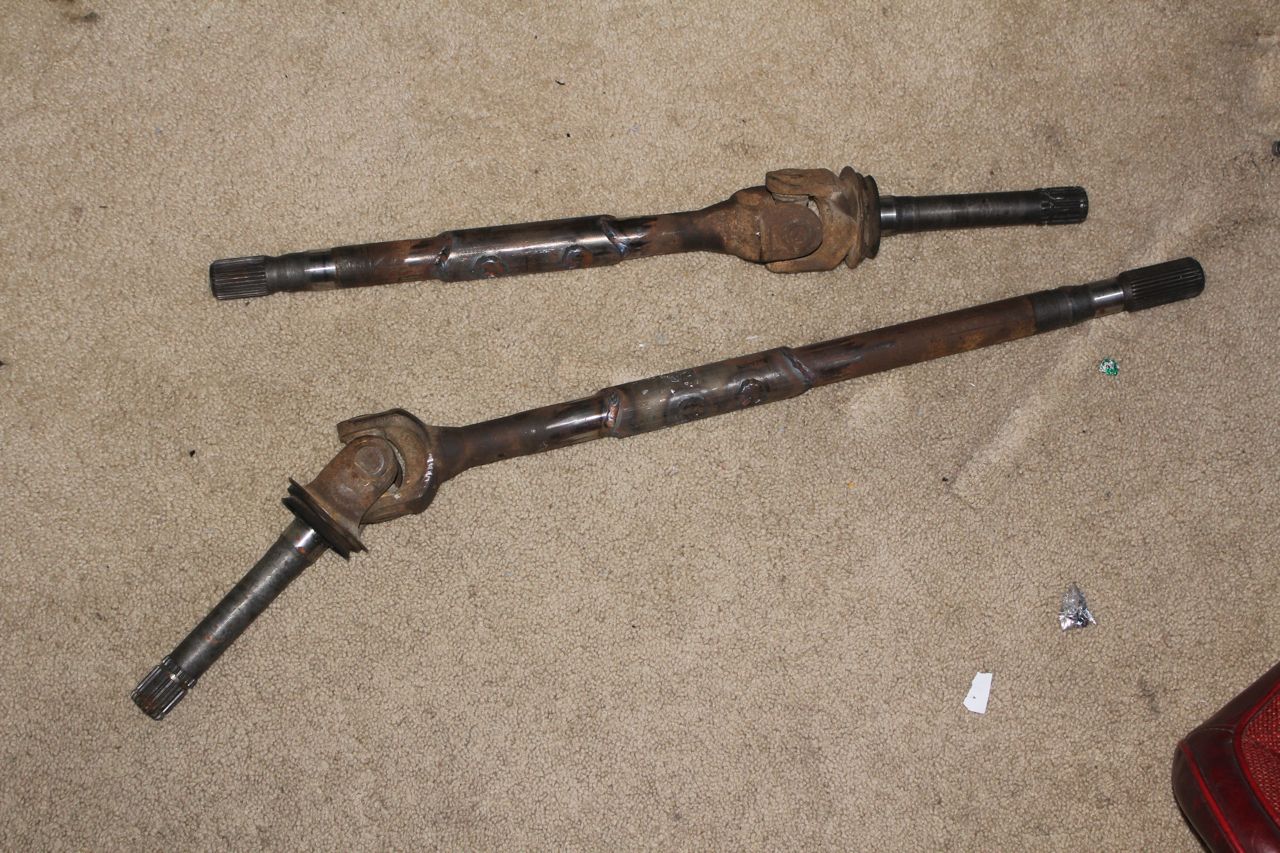

i cant find pics of the ones i did for Trevor maybe he can snap one or two
like said before 2 sets and sleeve them. i dont do the v cut but basiclly the same thing...

Here are the axles that Scott did for me
- exaxles3.jpg (239.38 KiB) Viewed 6146 times
- exaxles.jpg (253.44 KiB) Viewed 6146 times
