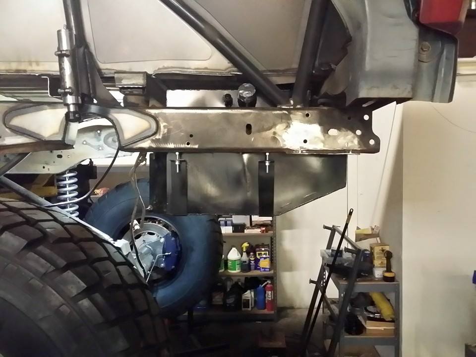

hollandermotorsports
Posts: 969
Re: Frame Notches, Inner Fender & Hydro Bumps???
Here is the signature CHO notch and plating that he did on many of our broncos. There are a few guys that run it without cages but I believe he goes a little more notch if he is caging.
