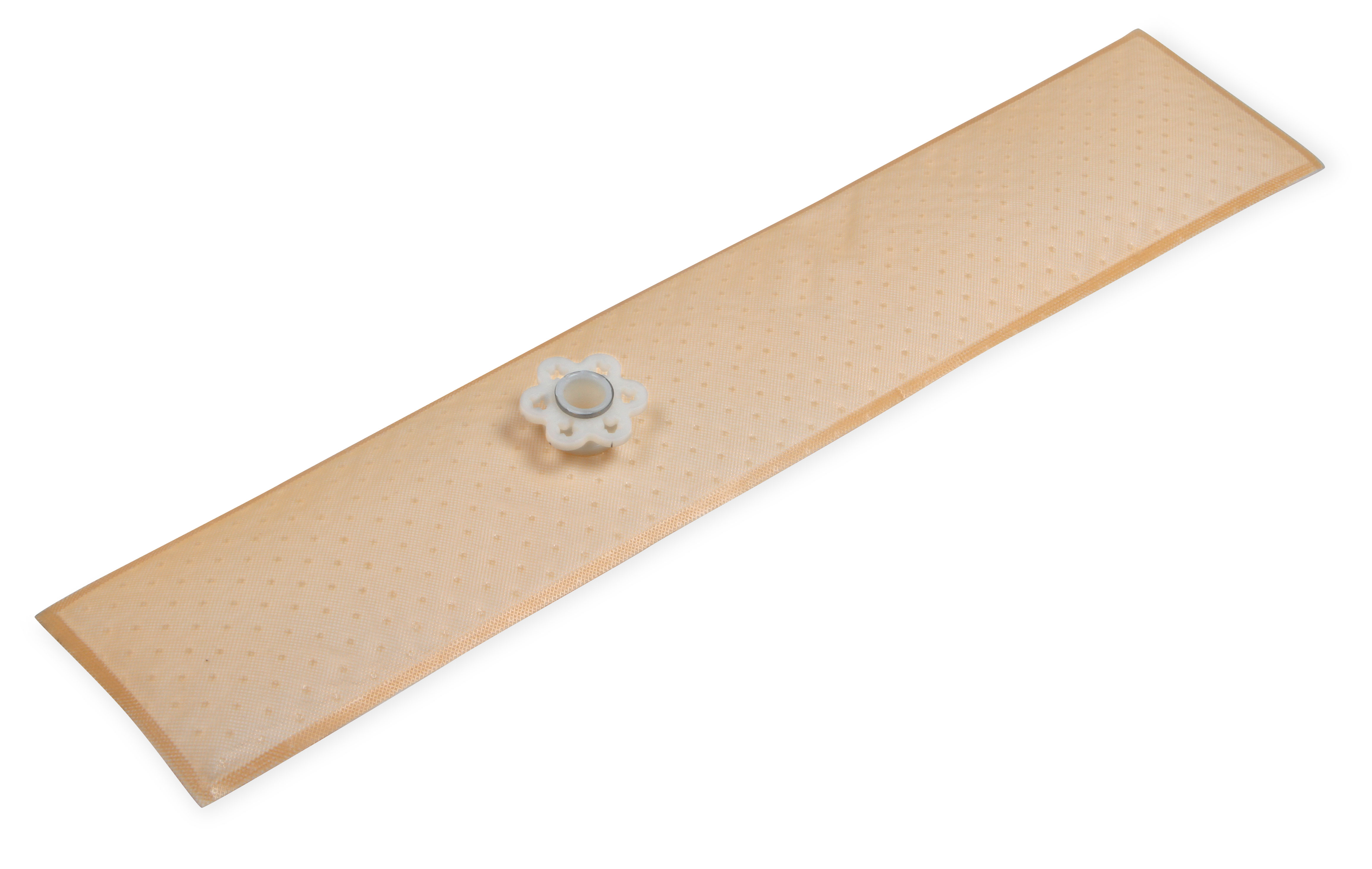

I have no idea how you will connect the hydramat to the Mustang style in tank pumps. I have not seen anyone offering a conversion fitting to adapt the 22mm pump inlet to the NPT outlet of the Hydramat.
There is hope for those of us wanting to use pump on a stick in tank pump and hydramat. Holley has brought out a Hydramat with an 11mm snap on outlet that will fit a variety of fuel pumps as long as it has an 11mm diameter offset inlet.
https://holley.com/products/fuel_system ... rts/16-111
There are pumps with 11mm inlet are available in two different pump body lengths 65mm and 81mm. I believe the Mustang style pumps the body is 81mm.
Here are two example pumps.
