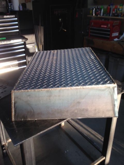

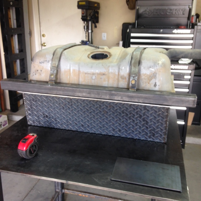

IMO not only do you need to make a bomb box for the tank, you also need to replace the flimsy stamped steel cross members. here are a few photos of the one I fabed still on the bench. 3/16 plate, so we can rock it in the rocks.

Didn't realize Tommy's was mostly hand fabbed/adjusted after the plates were cut. You may end up having to go the route most do = fabbing. I like the simplicity of a tube structure tabbed for a 1/4" aluminum plate. Not super fancy but it's strong, it works and the aluminum skids are replaceable if you ever really nail one.
I'm not sure there's enough of a market for anyone to really make one of these, unless they were a bronco owner making one for themselves & happened to save the files. And that leads us right back to the start of this thread...
