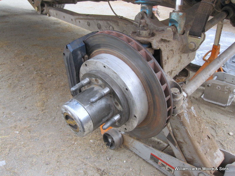

Post by gunit »
Check out this Dana 60 / 44 hybrid
14" rotors, 6 piston CNC calipers, D60 hub, BMS fabbed uprights, custom axles by Dutchman
Re: Bulletproof D44 TTB
i'd like to see more pics.. interesting
Now those are brakes! Who's truck?

My guess is Vanderwey 'Chevy' prerunner? Still a standard 44 Center section?

MOSS2 wrote:My guess is Vanderwey 'Chevy' prerunner? Still a standard 44 Center section?
We have a winner! You have correctly ID'ed the truck and it does have a standard 44 center.
