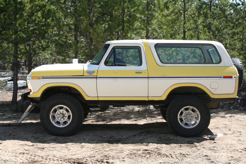

having run just about every color painted spring all likely stiffer then you are looking for (~500#) the best off the shelf are Ford 2WD springs I believe out of a van of the same era. Basically the same as what is in the white and yellow 79 Bronco sitting outside on 37's...
426 018.jpg (286.52 KiB) Viewed 2627 times
