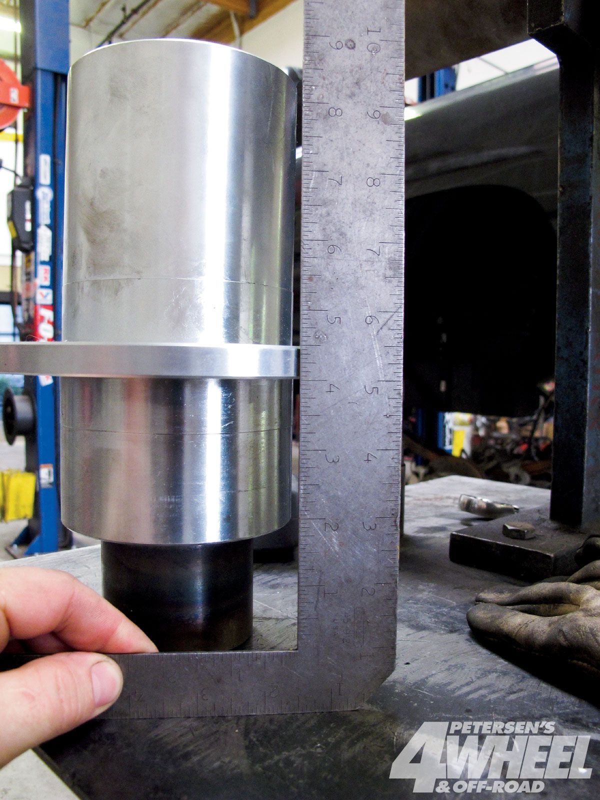

You might be able to do a full float conversion on a bronco 9" and hit 71" wms using 14 bolt spindles and hubs from Solid. Then you'd have 3.25 OD .25 wall tubes. I have a pic of the Solid spindle and hub assembled and before turning the spindle down for pressing into the axle tubes they add ~5.5" inches per side. From the pic I have it looks like the spindle flange has ~ 3" of machinable length for pressing into the tubes. If you want the pic I'll text it to you.
- Solid D60 Full float spindles and hubs
- 131_1105_04_o+131_1105_custom_full_float_axle+spindle_and_hub_measurement.jpg (299.58 KiB) Viewed 1990 times
