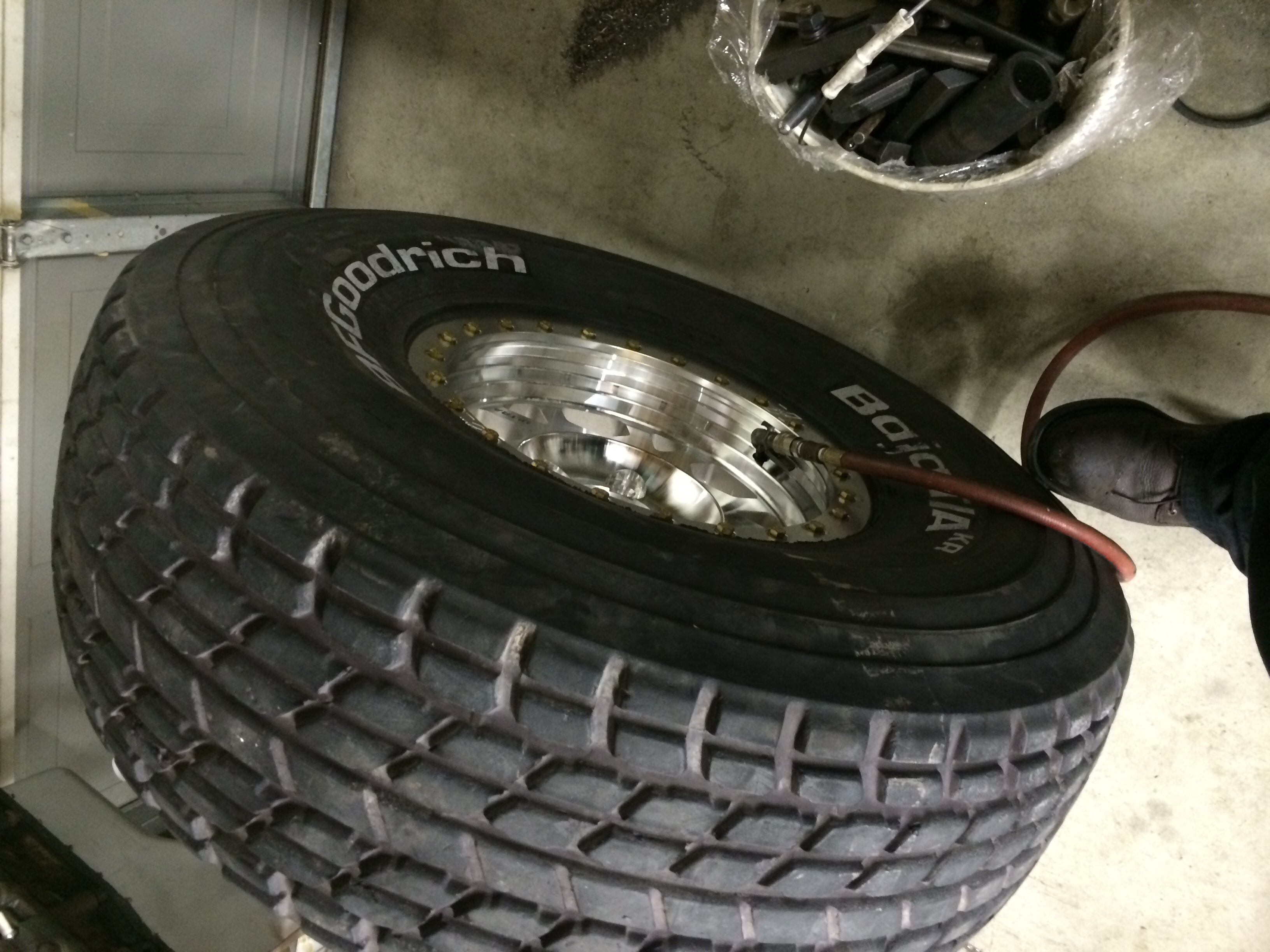

- Posts: 6028
Re: How to mount bead locks
With the air chuck filling the tire hissing air grab the tire with both hands and push the rim with your knee or your foot. This works ok if the tires aren't too old. Stiffer tires may require another measure which I will cover at the end.
- image.jpg (1.13 MiB) Viewed 1183 times

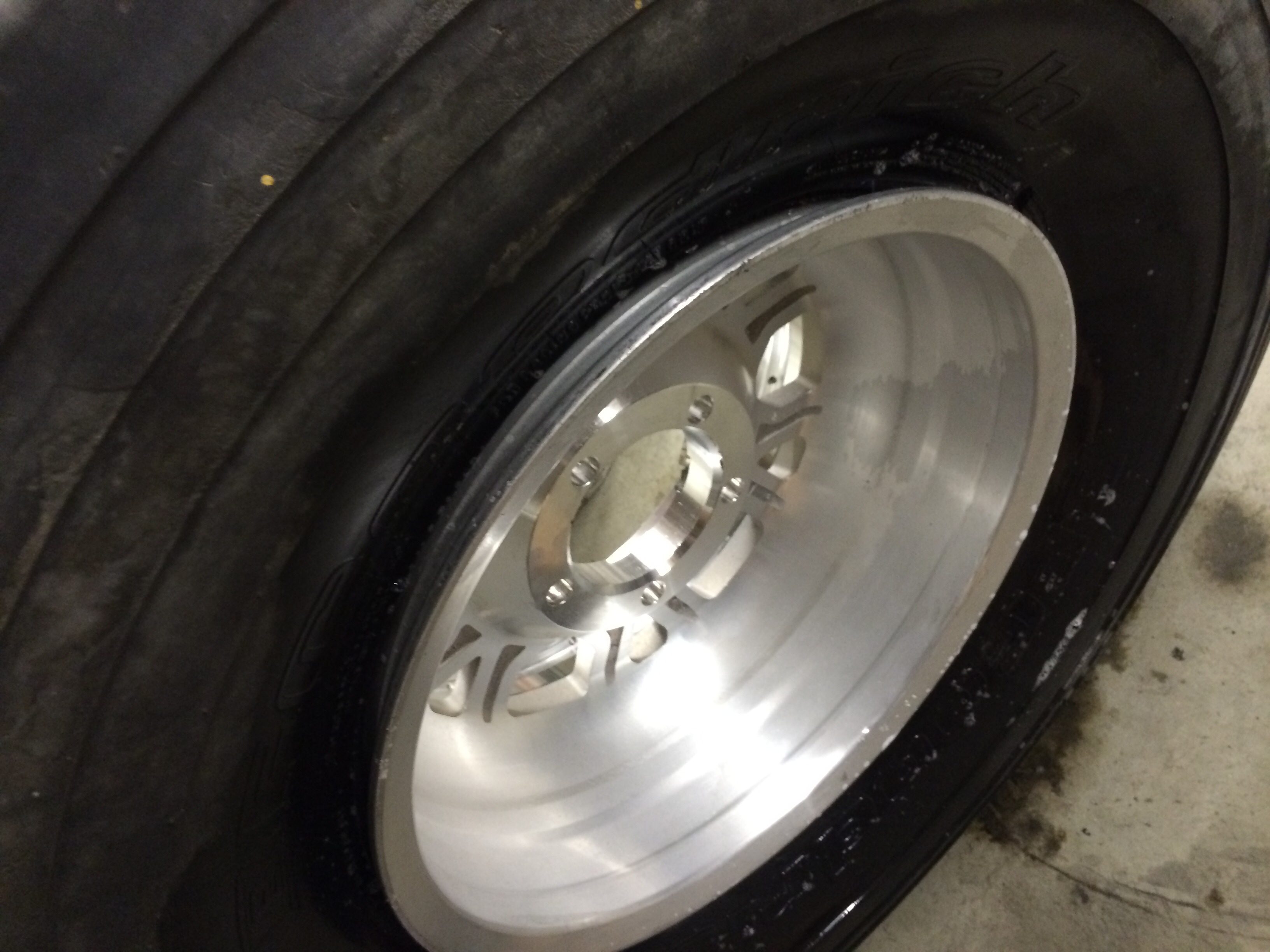

- Posts: 6028
The bead will seat and start sliding over the wheel toward the exposed wheel lip. FOR GOD SAKES KEEP YOU FINGERS OUT OF THE SPACE BETWEEN THE TIRE AND WHEEL AS IT FILLS!!!

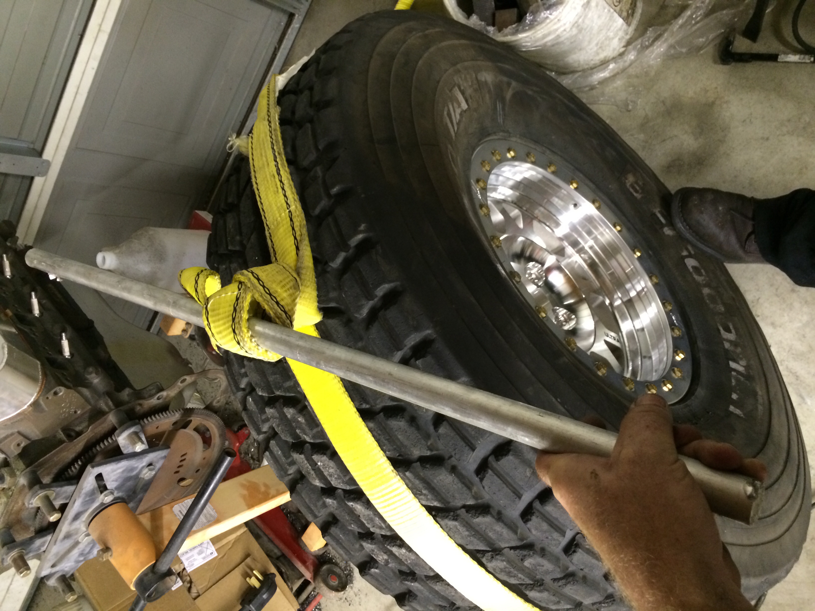

- Posts: 6028
So on very stiff sidewall tires you take a flat strap and place it evenly over the middle of the tire. Wrap the strap around a metal bar and begin to wind the strap tighter and tighter. This will force the center of the tire inward which deforms the shape of the tire forcing the beads to move outward. While filling with air after the dripping wet bead begins to seat allow the air pressure to unwind the bar with you adding light resistance. Once the bead has moved over the rim an inch or so remove the bar. The seating of the bead will follow shortly after.

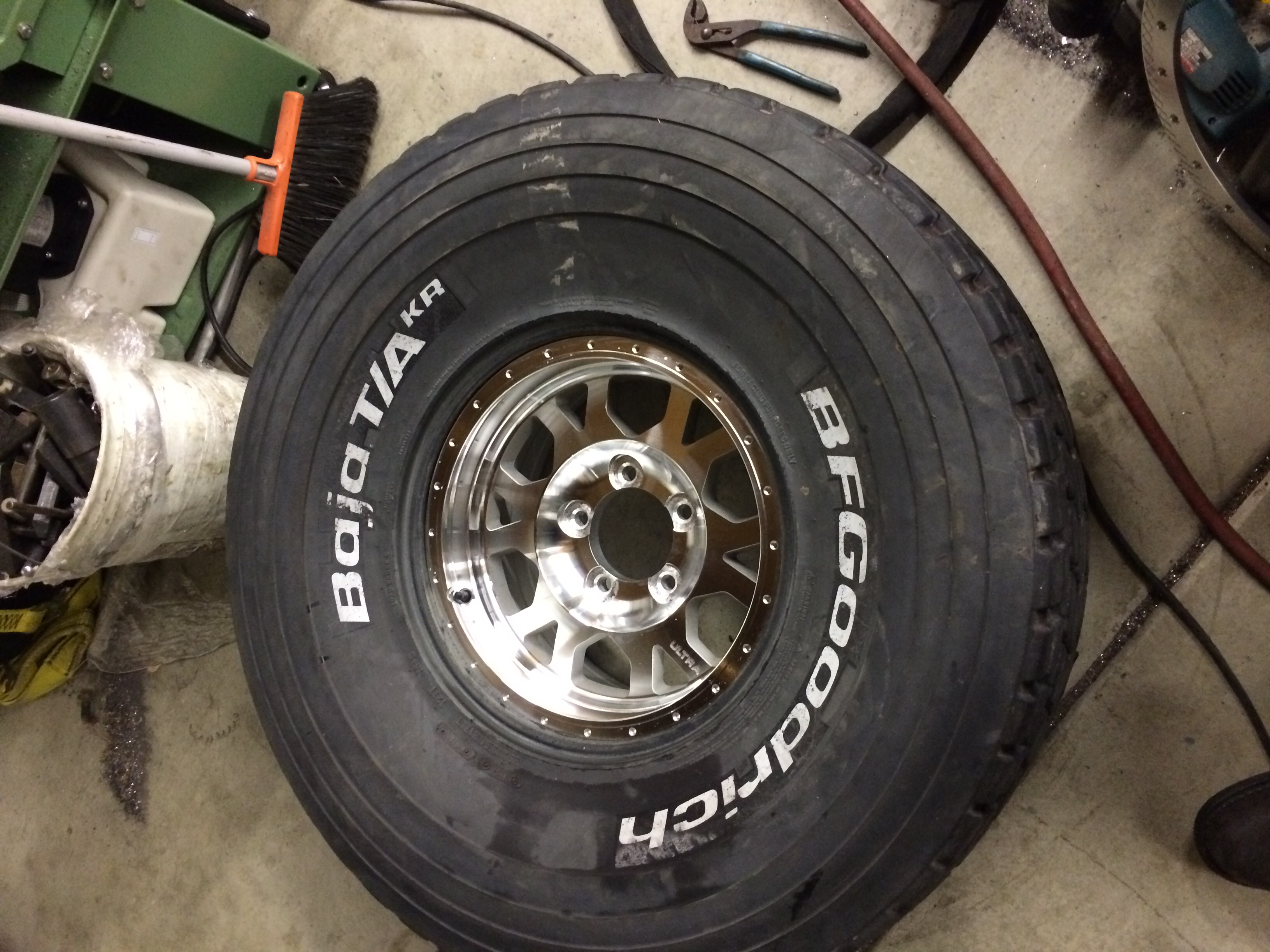

- Posts: 6028
The strap method also works really well with non beadlock wheels after you have blown a bead in the desert. Remove the tire, add the strap and wind it up. Start filling when visible contact has occurred between the bead edge and rim. Unwind as the air pressure increases.
