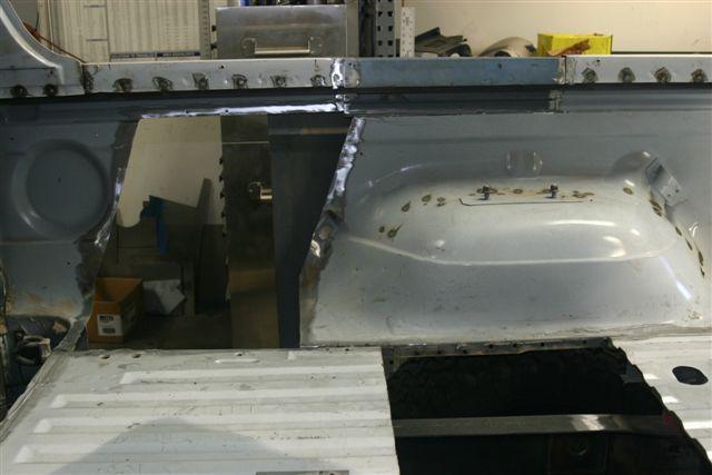

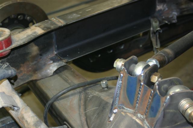

Drew.
After you decide bronco or F150 considering the end use and choose the Bronco see the pics of how Glen did mine.
It came out 17.5" stretch because I kept the E4OD. Choose a C6 and the stretch would have been around 11".
The frame was cut at the flat spot and a custom channel was butt welded in place. The pics do not show the plating that was added inside and out at the butt weld location.
The bedside was cut to minimize reshaping the stock contours and the inside preserved the stock back seat. My fenders are pushed out to the max without any buckling. The body used stock bedside parts from a doner Bronco and mated with stock inserts with no reshaping. All the panels were welded with the usual joggle. The top of the bedrail was reinforced with angle and when the cage was added the long runner from "B" to the back was welded to the bedrail. The coil towers fit nicely behind the stock seat location and are accessible from the top for both shocks.
So now you have an idea of how one fab guy did a stretch.
Results have been a success. It likes the SF whoops and the highway manners are good both with and without the sway bar probably due to the suspension design combined with the longer WB.
PaulW
PaulW
