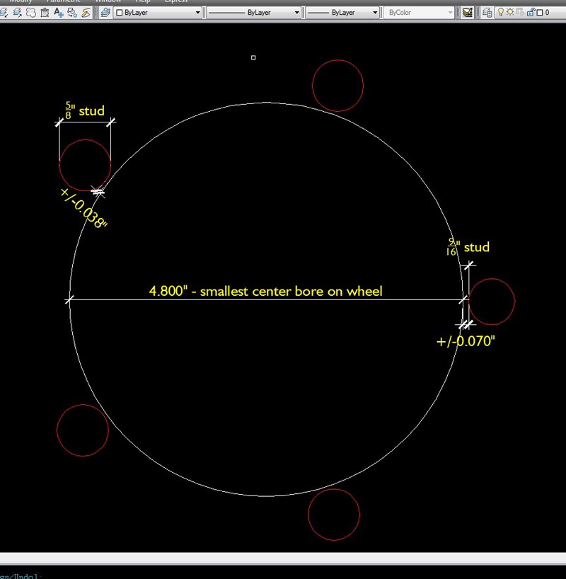

Thanks Steve! Im wondering if the holes could be welded up and machined if there is enough room in the center.
Re: Narrowed dana 60/ corp 14 bolt vs 9"
my concern would be the center bore needed to go over the hub vs. the lug pattern & how much wheel is left there between the 2. I'm not into what I'm currently doing at work so I'll whip something up in cad to explain.
Ok - here's a quick drawing to show how close the lug holes would get to the center bore. My guess is the lugs would hit the center of the hub itself maybe.
This drawing shows a 4.80" center bore - which would be minimal to clear the hub, and then both a 5/8" and 9/16" stud. Not much room for play between the 2
