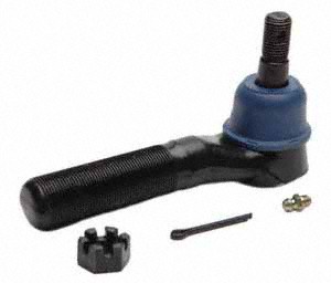

It took me way too long to find all this and then verify that it fit (Kris did the actual fitment checking), so I thought I'd post the info to keep you you guys from having to do the legwork again.
The following image gives you Raybestos (used to be Spicer) part numbers for upgrading (larger diameter) the tie rod ends for the right wheel. I looked and looked for replacements for the short side but just couldn't find anything... close, but not close enough.
You can buy these replacements at NAPA stores or anywhere that sells Raybestos chassis parts. These are the blue-booted high-quality stuff that stock-class racers use.
Also noteworthy, even on the heavier trucks that used the following heavy duty long tie rod, Ford stuck with the smaller diameter stuff on the short side.
Maybe the short side is not really a problem? Can some of the stock class racers verify this?

SteveG wrote:It took me way too long to find all this and then verify that it fit (Kris did the actual fitment checking), so I thought I'd post the info to keep you you guys from having to do the legwork again.
The short side that we tried to use had a kick in it that bound up the ball joints to where it wasnt installable...close but no cigar. The beefy draglink, sleeve, TRE fit like a glove though.

I forgot about that...shockseals.com wrote:Post up the alternate TRE with a kick in it as well...
In all the sifting through tie rod ends I figured out that there is an alternative to the straight outer tie rod end listed above.
Instead of the straight 401-1418 right outer tie rod end you can use a 401-1522 which steps up after the joint and raises the steering a bit and possibly out of harms way. All other dimensions are the same.
Keep in mind that I have not cycled a front end with the stepped tie rod end installed, so I can't tell you for sure that it won't run into the frame. I'm pretty sure it won't, but you should check for yourself since caster and bump stop locations can vary thus changing steering location at full bump.
The first picture is the straight 401-1418.
The second is the stepped 401-1522.
- 401-1418.jpg (17.73 KiB) Viewed 47729 times
- 401-1522.jpg (14.95 KiB) Viewed 47729 times
Would this offset TRE do basically the same thing?
