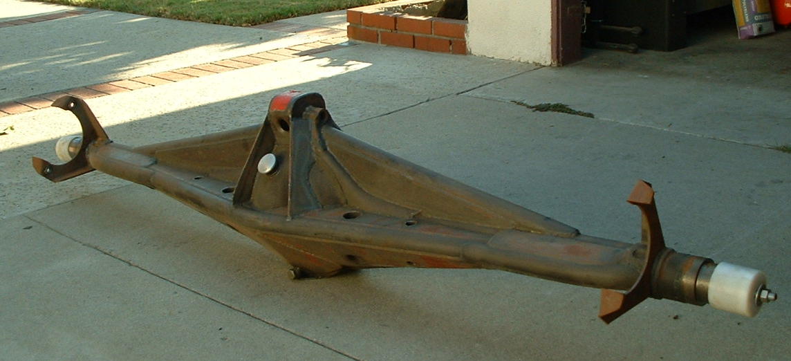

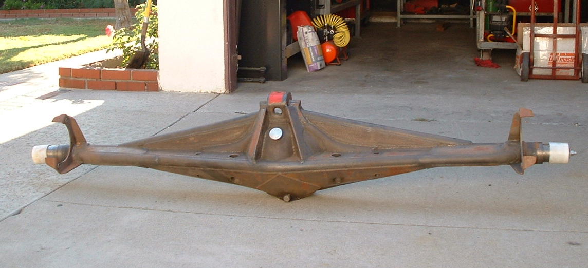

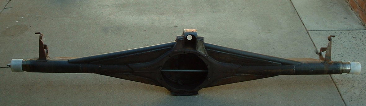

Can they re-tube a rearend that has been trussed?tcm glx wrote:
Why not take your axle to currie, and ask about havingnew tubes that re wider welded in... they offer a "re-tube service". You could likely uy new 35 spline axles of the correct length, and keep your existing housings and call it done.
Re: 35 vs 40 Spline
they'd either have to cut the truss off or just add to the tubes beyond the end. Either way it's kind of a pain and probably not the greatest way to go about it.
Here's a 9" my buddies did a while back. Was originally narrow & going in an exploder & then got widened to go in a k5 blazer. If you look closely you can see where the original truss & tubes ended & where they added the width.
