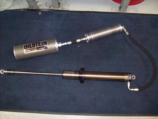

Exactly, the shock pictured above does generate heat at the reservoir due to the second valve stack. The length of hose pictured on the coilover would definately not be ideal for any heat exchange.
Try some rough math on the hose volume vs. the rod volume.
-8 hose is 7/16ID = .4375" this gives a 12" -8 hose an internal fluid volume of around 8.24 cubic inches.
7/8 rod is .875 giving it a displecement of 1.373 per inch of rod stroke.
So in order for even a little bit of fluid (let alone a big shot) from the shock to reach the reservoir the shock would need to cycle over 6". An 18" hose would need more than 9" of stroke.
As a subsequent design I ran this setup on the front of AGM's class 1 car at the 1000. The piggyback reservoir is full of fluid and the second reservoir houses the dividing piston. San Felipe is coming...

SteveG wrote:The Blackhawk reservoirs have valving in the reservoir which will also create heat... not the case with a non-Blackhawk reservoir.
- 100_0710web.jpg (93.4 KiB) Viewed 1461 times
