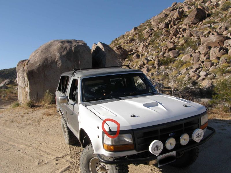

i've got fiberwerx fenders and a mcniel/perry hood.
i won't be buying from fiberwerx anytime soon. bubbles in the gel coat and a really f'd up mold. look at the circled part of the passenger fender in the picture and u'll see that a good chunk of the forward portion is missing. took me a while to get them on too. it looks really crappy... and that's something coming from me. (considering i don't care much for looks) glass is also thin.
i've got to concure with everyone else on this page... autofab is the way to go, unless ur planing on smashing the crap out of ur rig.
as far as perry goes i'm content with the hood. there are areas that are really thin however.
