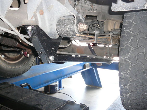

so heres the deal,...short story then questions.............
so i decided to run my bronco in a local tuff truck event figuring i built the the thing to use,why not have a little fun locally.... so i prep it and all is good to go.
i recently replaced my rear springs with a custom pack that i got from a member here and installed them set the pinion angle ,limits and bumps up accordingly did some garage driveshat mods etc....
i ge to the line up green flag drops i put a nice size dent in my floor board,hit the first jump and bang......along with a few more bangs...my yoke broke in two and i was done.
my buddy said that my tired hardly left the ground and when i caught traction it went.
so on to my question about axle wrap.
i have heard good and bad from alot people and want to know the skinny on 2-links.
i have been told to look into doing some sort of shackle in the front and hiem in the rear.
my thought is measure the distance from the center of the front spring bolt to the centering pin and use these measureme for length and then keep it paralell to the springs. i have never built a 2 link before and want to get this thing working right.so i can run it for a while before i sell out and 4 link it.
give me your thoughts,pictures and advise. thanks

This may be the wrong place to ask this question but.....If you have a two link setup, then as the axle drops and the two link swings in its natural ark , wouldn't this want to make the axle pull forward as it droops? If that is the natural tendency of a leaf pack to begin with as the axle droops it pushes forward then I can see how the two link would work in concert with it, however if that is not its natural tendency then wouldn't the two link be fighting the axle articulation? Just my brain trying to conceptualize it.

Re: axle wrap
Yup, easy answer.
When the links are designed wrong they fight the leafs and make the problem worse.
Place the pivots correctly and the links have no effect on what the spring does for normal compression and extension. All they are for is axle wrap. Its all about measuring and cycling. Just another geometry problem to solve.
Spirit did mine and being the sketpic that is my nature I went ahead and drooped the thing out and sure enough the links came out with little effort. A test that was good enough for me. Of course it would be better if I additionally had a way to suck the truck down to the bumps to see if the links were free for that case. If I ever build another shop I will include a link in the floor so I can check compression without removing the springs. Which is what I do these days. That method really sucks and is dowright dangerous.
Bottom line get links done by a pro that cycles them to verify they are correct. This is especially important if you have messed with the spring attachments.
Alas there is a good reason for switcheing to coils. and all this tech stuff about leafs becomes just history.
BTW, one can design these links so that the axle rotates for a rock crawler wanting to get rediculous travel and the u-joints become the limiting item. Guess what . That guy will be buying leaf packs even faster than described above.

Re: axle wrap
i will build the links myself,i know i am confident that what i build will last. this is the first time i have had a failure on any thing i have built that resulted in having a tow truck. there is a 4 link in the future on my bronco but for now i need it to work well for the rest of this year, i have alot of roads and trails that will be traveled so we can have our race up here in eastern oregon.
i wish i could go to phx and help out with daves class 3 and steal his design.i know his works and have heard great words from one his prep guys about his prerunner.....

If your building your own links, My personal preference is urethane bushings on the frame end and hiems on the axle end.
Re: axle wrap
Urethane urethane The voided kind. Weld one end cycle to full droop tak weld other end. Repeat. Done.

Re: axle wrap
I did the same test with mine (Autofab) during installation as well except I removed all but the main leaf and added a block to make up the difference. The geometry was just as John said... really good through the middle 12-ish inches of travel and pretty good during the rest of the travel (in both directions). Even beyond the middle 12" of travel I only remember 1/8", maybe 3/16" of misalignment between the bracket and bushing.PaulW wrote:Spirit did mine and being the sketpic that is my nature I went ahead and drooped the thing out and sure enough the links came out with little effort.
