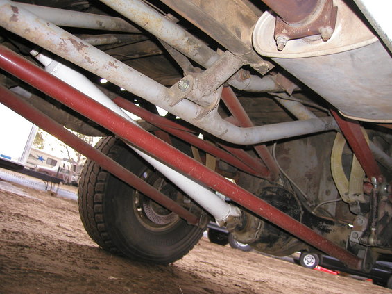

Here are a few pictures of one of Larry Ragland's old prerunners.
- whiteblazer.jpg (17.98 KiB) Viewed 3072 times
- PA110002-2.jpg (116.91 KiB) Viewed 3072 times
- ragland-blazer.jpg (47.27 KiB) Viewed 3094 times
- Ra.jpg (81.19 KiB) Viewed 3094 times
- RaglandBlazer02.jpg (80.44 KiB) Viewed 3094 times
- RaglandBlazer01.jpg (82.43 KiB) Viewed 3094 times

that what i am looking for, it looks to like there is still room inside unlike traditional 3/4 link set up. i'd like to see some pics of the interior!
simple looking set up
thanks steve
thanks steve

I unfortunately don't have any pics of the interior but remember seeing the truck when Larry still owned it at the Parker 400 in '95. The rear had boxes of sorts that covered the spring/shock area (similar to some c/o Broncos) but still had at least one center rear seat iirc.bajascott wrote:that what i am looking for, it looks to like there is still room inside unlike traditional 3/4 link set up. i'd like to see some pics of the interior!simple looking set up
thanks steve
I'd be curious where that truck is today. It was an interesting piece - built here in Phoenix by a guy named Wayne Stump, I believe. I remember that he had engraved his name in the steering wheel hub.
Re: mezanine arm set up
At the time those pictures were taken it was owned by a guy that owned a foundry in Fontana (I think). It handled really well. A friend of mine helped replace the rear springs a while back and he said it was an incredible pain in the ass and that they were HUGE. The rear structure took up a ton of room in the cargo area. I think using a single large coil-over instead of multiple shocks would be ideal.
EDIT: I added a couple more pictures.

Interesting rear end truss... I wonder why more people don't do a truss like that?

i diddnt notice the way it was trussed, killing two birds with one stone.
a coilover would be ideal. im curious what kind of spring rate would be used on a set like this.

Because it doesn't add enough weight and won't make it to the moon and back.philofab wrote:Interesting rear end truss... I wonder why more people don't do a truss like that?
