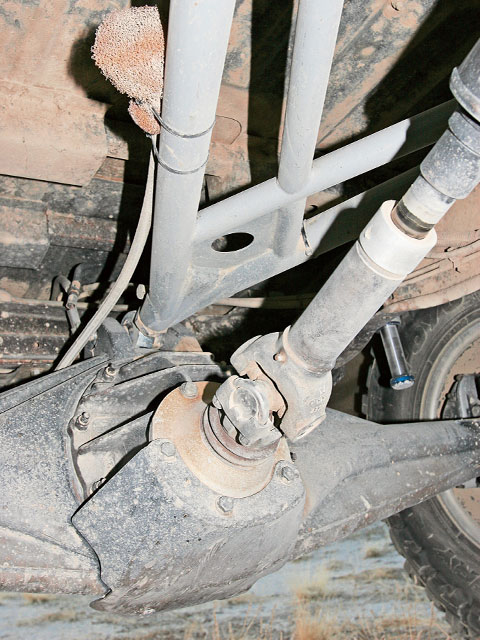

An upgrade that is often overlooked is the addition of some sort of ant-axle-wrap device. The most common is probably a "2-link" kit which consists of two bars attached to the bottom of the axle-tubes extending forward to a bracket on the frame rail.
A properly designed 2-link kit allows the axle to freely move up and down and articulate, but stops the axle-housing from rotating under load (acceleration and braking). This will eliminate most if not all of the rear wheel chatter and allow you to run a softer spring which will promote wheel travel and articulation.
In the following picture you can see the two-link bars and brackets as well as long-travel leaf springs, 12" travel shocks mounted under the floor and the side plates of a bolt-on upper shock mount structure.
There next most common anti-wrap device for the go-fast Bronco is probably an upper link which attaches to the top of the differential housing and extends forward to the two frame rails. Imagine the upper link on a 3-link coil-over suspension. This one will be trickier as there are no "bolt-on" kits available as of now.
[See image below]
[See image below]
