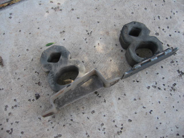

They are older Pathfinder rear bump stops and are a rubber that looks like a number 8 (small O stacked on a big O). I don't remember what years they used these on. They seem to hold up very well and I've been unable to hurt them.Nick wrote:Ok, i'm researching poly bumps for my build. I know that some will say that the stockers will work, but i'd like to go a step above those. Air bumps aren't really in the budget for now, so what else can i do without breaking the bank?

i swiped a pair of the nissan pathfinder ones too, but i don't really like how big they are or the way they mount (they would be best in a rear application where you have more room on the frame). i can send you those too if you are interested. they came on mid-late 80s pathfinders (the boxy ones)

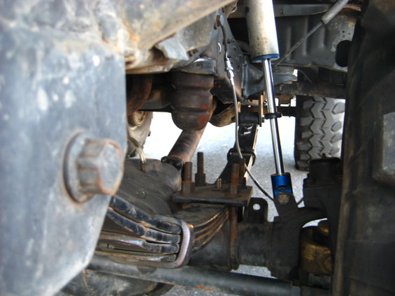

I run the Nissan bumps on the rear of Patch. Thanks Chris for the suggestion years ago. I'm about to install a set on the front as Patch does have the room though the height is a bit of a concern. No, Patch is not a Bronco.

Attached are a shot of the Nissan bumps on the rear of my EB. Pathfinders started in '86? and they started using them from the intro up into the '90s sometime. Scads of them in the junkyards - cheap and easy to find in good condition.Nick wrote:Ok, i'm researching poly bumps for my build. I know that some will say that the stockers will work, but i'd like to go a step above those. Air bumps aren't really in the budget for now, so what else can i do without breaking the bank?

Those are the ones I use on the rear of my bronco. They work great and are holding up under heavy use.

What I've frequently seen is that the plate stays with the vehicle, but the urethane goes MIA when they start getting worked hard. I've not used them though, just my observation. I have used the Nissan parts fairly hard and am impressed with them.
