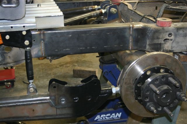

What was done was I started out with a stock bronco that had a dumb lift kit. Took that stuff of and trashed it. Hired Sprit Racing to put their front kit. tall King CO & bumps Then I hired a diff company to build an ARB 10.25" rear which I had Spirit modify to make it correct. After several years with broken rear leafs each year I gave the truck to Glen Strightiff at Complete Fab and he finished it. I still have the Spirit front but Glen has plated it and repaired some cracks.

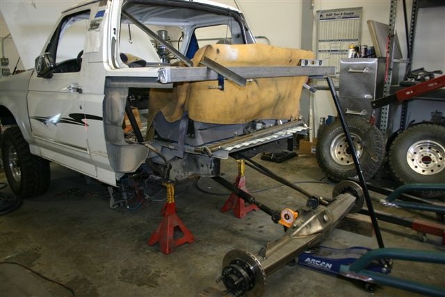

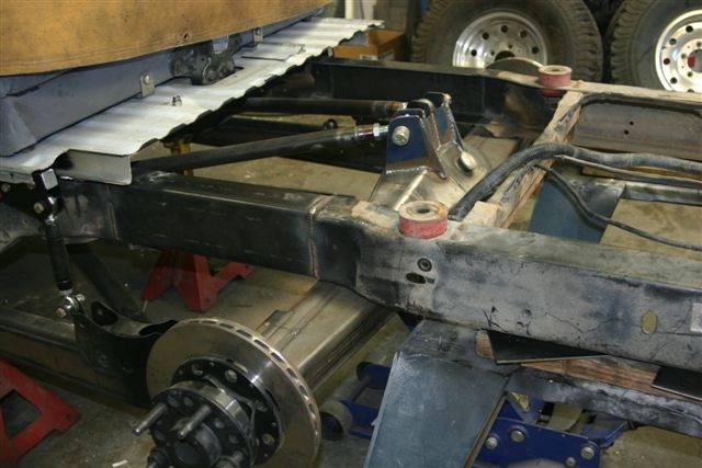

Glen put the 4 link together with the truck carefully set up on the floor using his link jig and he decided on the stretch . The primary goal was to eliminate DS plunge and get a reasonable amount of travel. To accomplish that he lowered the transfer 1". The frame insert is the same material/thickness that Ford used installed butt welded and plated. The rear suspension design is classical TT/C8 that Glen builds all the time. Mine is different in that I used air C/O shocks to allow ride height adjustment for widely varying loads like passengers or extra pit boxes. Also installed Fox, 4 bypass res shocks & bumps.

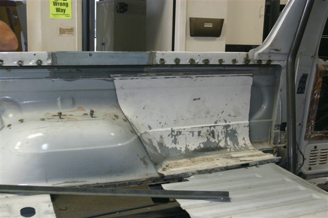

Sheet metal was more complicated, The floor was cut behind the seat ., The bedside was cut in front of the wheel arch. He used a donor Bronco for the parts to be inserted. He hired a sheet metal body fab guy to make it all fit. The top is 2 tops spliced together with 3 "V" ribs to brace it. The windows are custom (A big mistake due to cost.)
Bought a used Tubeworks rear from a racer and let Dirt Tech prep it for the 4 link. Jason Hughes put the internals together. 4.56 spool. Glen installed the Mitler Bros steel FF ends with 40s axles

Pickup bedsides take way more $labor$. What was done is patch panels from a JY donor Bronco. Panels for the floor, & inner and outer fender. Pretty logical since you will still need a donor even if you were to use a whole bedside. No fiberglass for mine because of the modestly wider axle. The fenders were just pushed out and re-welded. My axle width came out as the same as the E150 vans

Another reason for a stretch is the use of the E4OD/1356. I have 3/8" Driveshaft plunge and my 1356 is lowered 1". All that still required a 17+ inch stretch. No issues with CV or U-joints. E4OD that means a big stretch (17.5").
